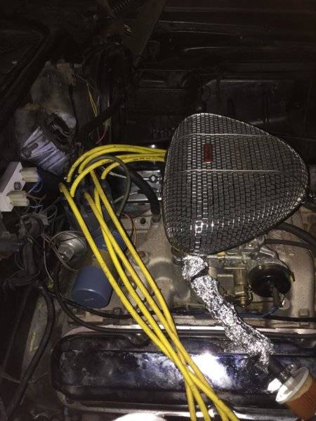

My '74 plymouth Satellite will cold start fine, but if the car has been running for +15 minutes, it wont start back up after sitting for about 10 minutes (it cranks but won't run).
The car has a 318 engine and a 727 tranny. I replaced the distributor cap, rotor and coil.
It can't be vapor lock, since I've watched gas freely move into the carb, and the fuel filter is filled when I step on the throttle. This only became an issue after I put a new rotor into the distributor (something broke or came loose inside the distributor?). So, assuming it's a spark issue, should I buy a new distributor or ignition system?
If that's not the case, why won't the car warm start?
Here's a visual of what I've got going here (side view from passenger door)
Sounds like your losing some spark from the new parts. Have you checked the timing and are you positive fuel is spraying down the carb throat ? Heat soak is a HUGE issue with the ethanol in the fuels. I just looked at the pic, and see the clear filter. You're getting fuel to the carb but when it sets it's possible the fuel in the car has boiled out.

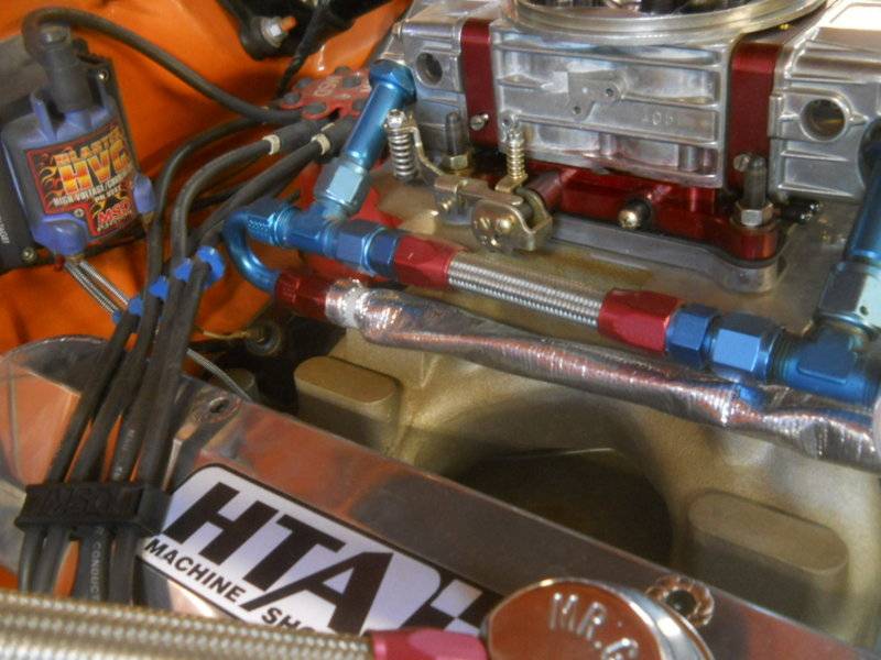

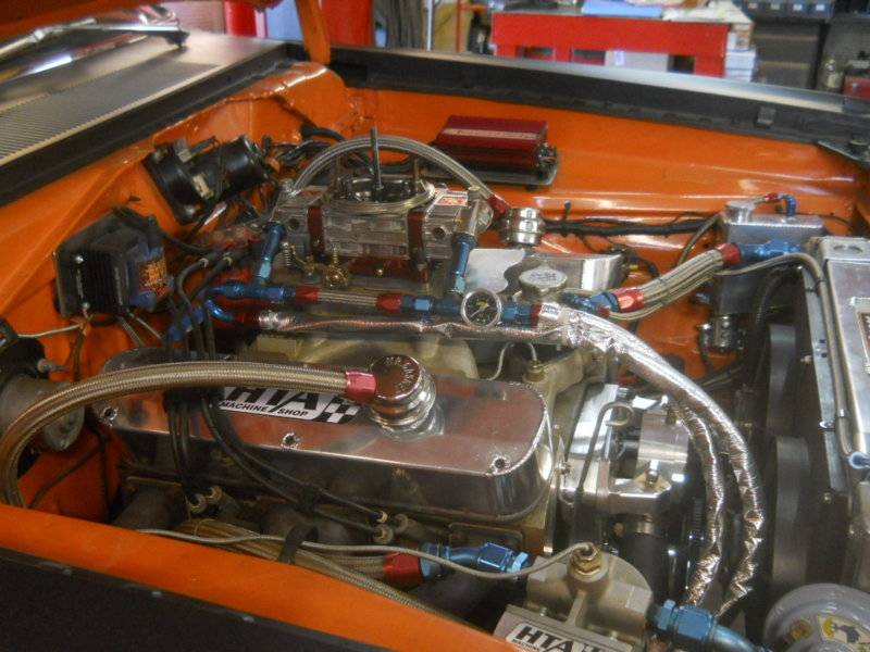

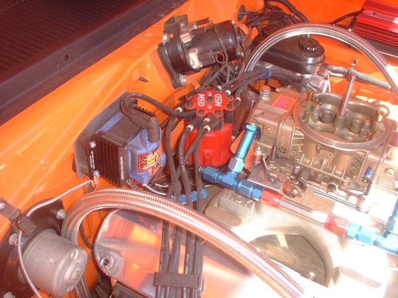

Here are before and after pictures of what I did. I put a pressure regulator after the carb then ran the line back to the tank. You can do this with your vent line if you have one and install a vent on the fuel fill tube. Use the three leg filter.
I had an electric pump so I needed a regulator.
They have return regulators they are different than supply regulators.
Check for spark before you retune it.

That looks like a running son of a gun man
