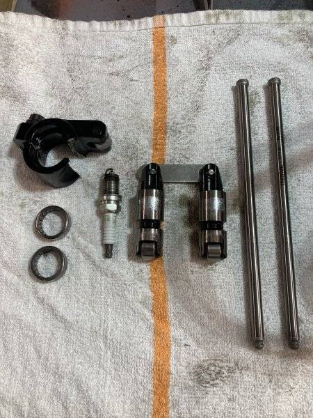

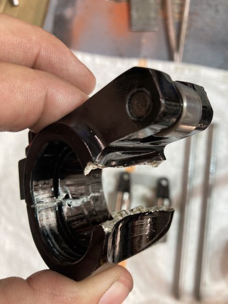

Back to the issue at hand…. I tore the 727 loose and completely disassemble, only to find a zero issues. Now feeling frustrated and beat, I turned my attention to the engine And did what I should have done at the moment I got it back to the pits…. Removed the valve covers to inspect the valvetrain…..
Quickly found a broken rocker. Was elated to see the needle bearing cages still in tact and on the shaft. Pushrod us unhurt. Went to the lifter valley and found no damage at the cam lobe or lifter. Did a leak down test and found no evidence of valve damage.
I think ive managed to dodge a bullet here; minimizing damage by shutting it down quickly. Yes, these are cheap Speedmaster / Procomp rockers, which were carried over from the 451. Probably (definately) a big mistake with the current spring loads.
I’ve ordered a set of Harland-Sharpe 1.6 rockers, they should be here next week. The 727 will also get a refresh as it gets re-assembled, and with any luck I’ll be back on the chase on the 19th.
Wow nice catch.
Even though they are cheap rockers its a good deal that the bearings didn't come apart.
I din't know at what point lift and spring pressures when the valve train needs serious attention, but I had issues running 0.726" lift with 700+ lbs open pressure.
Look how much material is removed for the bearings.
