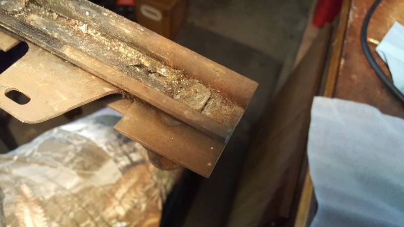

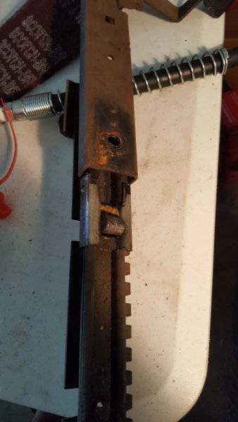

This was a good video but it was weird that my seat tracks did not come apart the way the ones he did in the video. Instead of the bent over corner, mine appear to have a stamped indentation that stops the track and cannot be taken apart Does anyone else have this situation
Mine is different than the one in the video. I had to drill out one rivet on each track to slide the rollers out. You can also grind the base of the carriage bolt to get it to slide out then the tracks will come apart. So, you have to do one or the other to get it apart.
