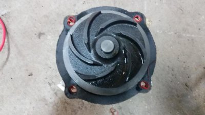

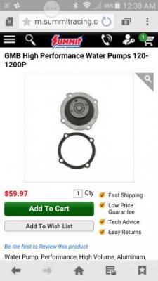

Tore my water pump apart to see if I had the right one.... go figure, nope. Thought I'd post my finding for anybody interested, Summit sells a reverse rotation pump and it's not expensive either.
Thanks, I'm buying the top one although the new ones are billet, that one looks like steel?

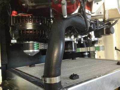

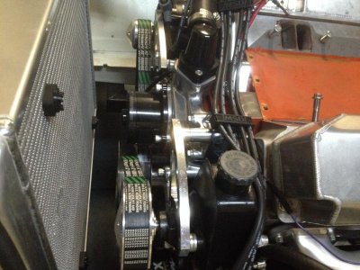

Finally odered the kit, should be here by the weekend for installation. I've been pecking away at the electric fans, condensor and the Vintage Air A/C unit, I've got both all wired up minus the battery connection so I'm close but still need to plumb it all up.

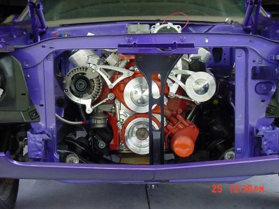

I installed the March serpentine set up on my last 1970 Challenger R/T restoration. This car has a "Stroker" 500 cubic inch RB big block.
This is a view of how it looks installed. We went with a R134 A/C system that uses a Sanden compressor. The March unit came with all of the billet pulleys, but I still hadn't installed the alternator pulley in this picture yet. You can see it ( the alternator pulley) sitting on top of the alternator in this photo. The system was for a Saginaw keyed power steering pump as well.
The only SNAFU we ran into was I had to machine a spacer for the water pump pulley.
(please don't pay attention to the dented oil filter)
This was one of the first systems available for big block mopars back then. I'm sure that others have come along and made improvements. I just wanted you to see how the March system looked.
Hope this helps.................

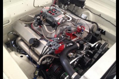

and you can still use your mechanical fuel pump too.
One of the nice things about SD's stuff is the unit uses readily available replacement parts that can be sourced anywhere. Other than the billet brackets and pulleys, you can get that stuff even in podunk. Can't say that for the other companies.
