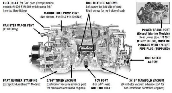

Whoa, hold on now .. so you also say use full manifold vacuum for the advance can ? I said that and was shot down in another thread on FABO ! It seems most like to use ported vacuum ...

I'm not going to get into a discussion on Ported Vs Constant I have explained that no less than 50 times over the years... Ported is for EMISSIONS and CONSTANT is for non-computer controlled engines or Performance. Even Edelbrock has that one figured out finally after 25 years of arguing with them.
