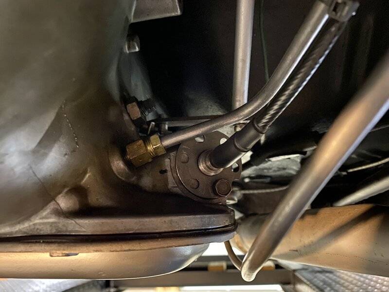

Something else I ran into with this little project that I would appreciate any thoughts / experience on. My shift cable runs behind the exhaust down pipe as seen in this picture.
There is quite a bit of upward tension on the shift cable where it goes into the case. I was hoping I had enough slack in the cable to reroute it to the front of the exhaust pipe so there was less upward tension on the cable but there wasn’t any slack. Can anyone with a stock exhaust tell me if their cable runs in front of or behind the down pipe?
There is quite a bit of upward tension on the cable connector with my setup and while the shrink tube seems to have stopped the cable leak for now there is still seepage around the ORing coming through.
I didn’t realize it before but it is pretty easy to wiggle the cable threaded shaft in the adjuster wheel. Seems like it could use a thin nut on the outside to help keep it centered in the case hole?
Try removing the wire tie and gently tug on the cable watching how it is routed up though the firewall for any chance to find any slack. Also check under the dash. Don't like the wire tie being so near to the adjuster or if you replace the tie, move it further away. You should have at least an inch or so of clearance away from the exhaust to prevent it from getting too hot. As a precaution I used a heat-resistant jacket in the area of the exhaust. Could also use a wrap.
I’ve checked for slack , there is none. Was wondering if the cable might not be correct for the car- too short? That’s why I was curious where others have their cable with a stock exhaust. Right now the cable is a good 1- 11/2 away from the pipe so not concerned about the heat (though a heat shield would be a good idea) but I don’t like the upward tension it puts on that cable.
