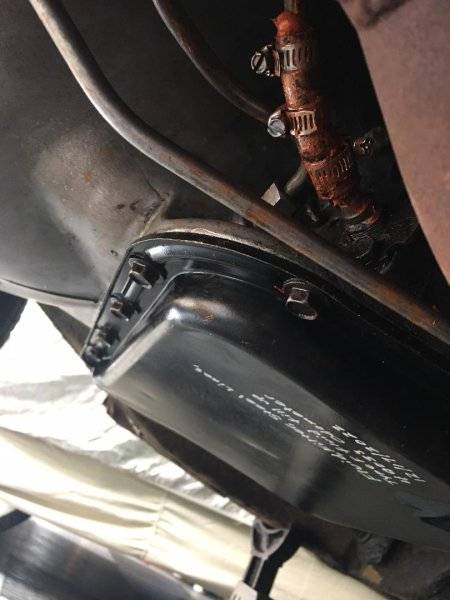

The shift cable in my '63 727 is dripping. Doesn't seem to be from the O ring. Looks like someone tried electrical tape without success. I was considering cleaning with brake cleaner, splitting some rubber trans line, use permatex on it, secure with hose clamps.
Other than replacing the cable from unobtainium parts, any other suggestions?

I just now finished cleaning with brake cleaner, spread ultra copper on the cable end paying attention to the joint, split a 4" long piece of 5/16" hose, filled it with ultra copper, slipped it on and used 3 hose clamps.
Gonna wait a couple of days and I'll report back with the results.
Thanks everyone.

The Ultra copper seems to have done the trick. I honestly believe that I omly needed to clean and use a very small amount where the black cable housing is swedged into the cable adjuster.
I went overkill. Don't think that it will ever leak but the repair could look a lot better.
