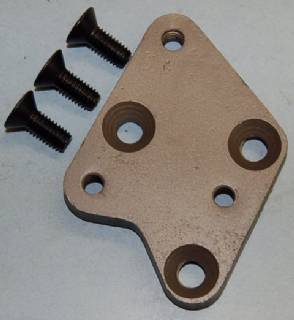

This is the exact one I have (Hurst Competition/Plus):Brewers list the same stick he is using. So what is the deal? what BOLT IN stick will work.
http://www.brewersperformance.com/products.php?cat=273The adaptor plate is the problem - doesn't work with that shift handle.
Not sure that's a Chrysler shifter. Should it not have smaller rod link holes? I have never of the four Hurst Chrysler shifters had one with the large holes. Bushings should take care of it but with the right shifter they should not be needed. Can you post a picture of the shifter levers? Thats were I believe the real problem is.This is the exact one I have (Hurst Competition/Plus):

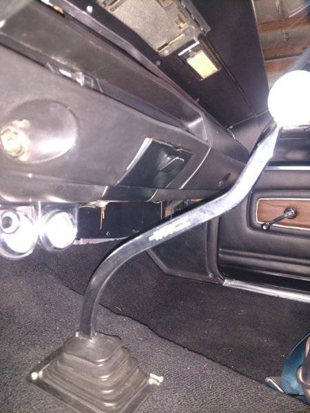

Sure, gimme a minute...Any chance you could take a pick of your shifter in first gear so we can see how far forward leaning the shift handle is right as it comes out of the boot?
It's not. It's the same Hurst shifter you can buy right now. Application is, of course, for the non-console cars, which mine is.
Yes, it has the bushings.
