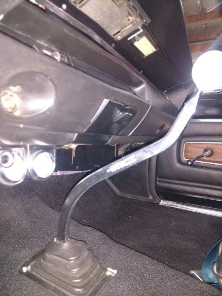

Shifter hitting dash

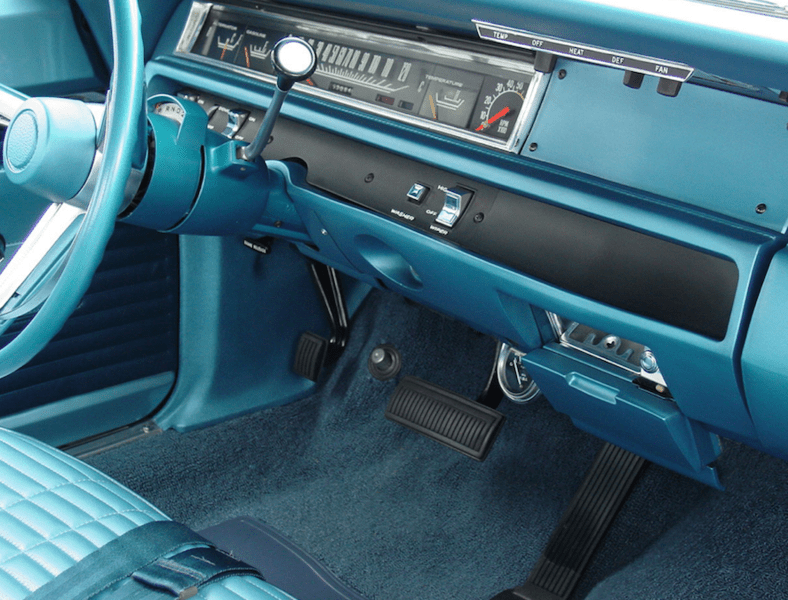

Here's mine in 1st gear (flop-open ashtray closed). Crap generic boot installed, think it's a MrGasket or
some such:
I can just about get my fist between the handle and the dash at its' closest point.
It appears that the angle of the shifter is much different than the OPs
I don't think there is a difference in shifters between console and non console cars, is there?

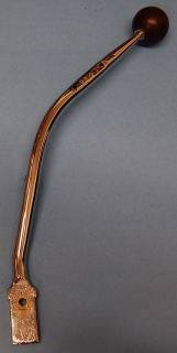

Stealing a couple pics from Dan Brewer here, for Hurst shifters in B-bodies '68-'69:
Non-console shifter handle
Console shifter handle
As far as the shifter mechanism itself goes, I know of no difference at all...

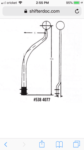

From what I can tell by looking his pic, it “appears” he has the “correct” stick, however the C body stick is similar, but would have the ball about 5” closer to the dash.
Probably worth measuring.
View attachment 808836 View attachment 808837

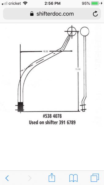

The OP has the 4077 handle, MO. If he removes the handle it probably is stamped 4077, Not sure handles from Chrysler are stamped. Spent many hours looking at handles for my 65 Dodge, bought a 4078 and its close to dash with engine set back 1.5".

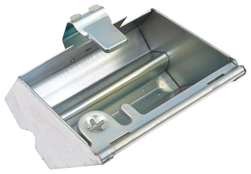

That's not the early ashtray.... The early ashtray slides downward to open...
Meh, whatever. It's one of these:
It's original to the car. Car has a build date of Dec. 1, 1968....none of this of which is helping the OP, I'd suspect.
No, it's not helping the OP, but twice you've stated it's the early design... So I thought it would be nice to get the facts straight in case anyone was wanting to learn something.... Early design ashtray....
No, it's not helping the OP, but twice you've stated it's the early design... So I thought it would be nice to get the facts straight in case anyone was wanting to learn something.... Early design ashtray....View attachment 809079
I apologize for my egregious error and thank you for the correction.
Besides, I like mine better anyways. :-)
:drinks: Everybody has to have a preference.... Since my car has the early one I kinda like it....
some such:
Thanks for the pic.
That’s how I remembered mine....... not really all that close to the dash at all.

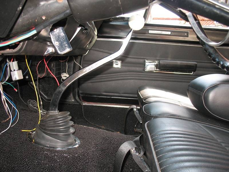

In the OP’s shifter pic........ it looks as though the angle of the shifter handle is way too far foward.
It’ll be interesting to see which part(s) of his set up are incorrect.

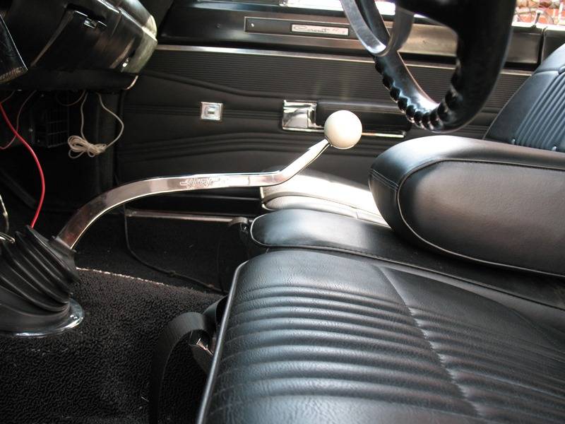

I think I may have a happy ending for this thread. Since I was able to drive the car, I was in no hurry to solve this problem, although I was trying to find a solution I could live with all along. I went to a swap meet and saw a shifter mechanism I thought might work, due to the position of the shifter handle lever (further to the rear than mine). It was out of a Camaro, but looked very close to mine. I tried it on my car, but it wouldn't work. I then took both mechanisms apart, and traded the shifter handle levers. It seems to be functioning OK. The photos show the positions of the handle in reverse and fourth gear.
