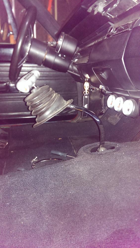

Here's the one I'm thinking vs. the one correct for my car and a pic of what's in my car now.. Mine is about 18" long with almost a 13" layback

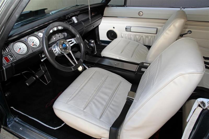

Later model pistol grip with carbon fibre handle, still got the wood one though

That entire configuration, buckets, console etc.. would be my dream if I ever get my car to that stage!

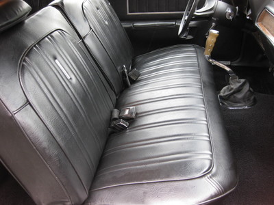

I've been in talks with another member (youknowho) about making one for me if I send him a template. But I'm still thinking that 14.5" 71-74 shifter might be exactly the fit I'm looking for! Just wish I could find a pic of one in our Gen with a bench. This is the only pic I could find 7.jpg

Is that still the original boot on that shifter? First one I have seen other then the one I have been trying to replace for years.

I'm pretty sure this car has a 71-72 shifter in it. It looks smaller/shorter than a 70 from the pic. I'd love to swap to a shorter shifter. The factory one is ridiculous.
