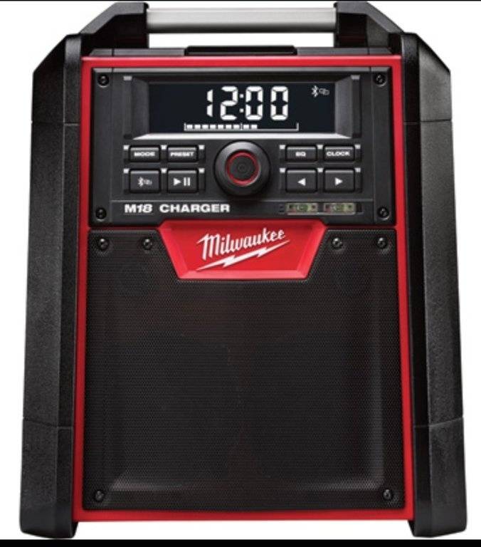

My Milwaukee radio does good in FM with my shop lights on.
I assume a radio sold by Milwaukee tools? makes sense as it would be for inside construction work too.. Always flouresent lights around those conditions. . Thanks.................................MO
