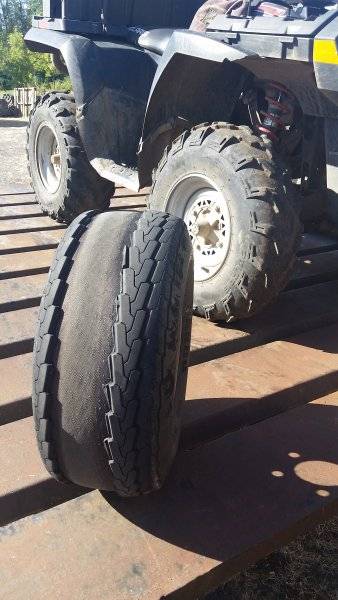

I made it home on this trailer tire. I went ahead and replaced it even though it still had about 40% tread left.
