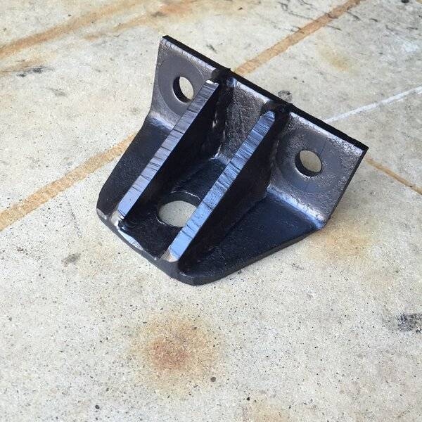

I love it when somebody comes up with a great idea. I just received my set of tie down plates from mrrandyj. He made mine for my Dana with Caltracs which look a little different than this picture. They bolt under the existing shock plates. I was so tired of messing with axle straps and these fit perfectly. Randy's a good guy to deal with. Modest price and great value.
Those are terrific. My loops were welded to shock plates. Not this neat. I set my car in trailer where I like it to ride and made two chains with quick hooks on each end. When I pull it in to where rear wheels are at hinge its easy to crawl under and snap the hooks. Then I pull it with winch til chains tighten and center. I then chain front to loops I welded to K member and snug with chain tensioner. I usually relax winch just a touch and it rides super. Loads same every time. Love your parts. Dave

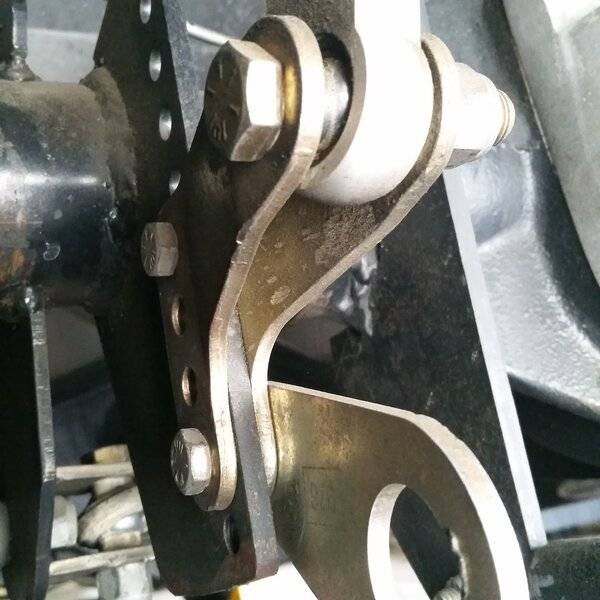

I bought a pair of tie down brackets from Mancini and mounted them on the lower shock mount bolt on my ladder bar setup. Works great. Easy to reach and no axle straps required.
Mike do you cross the rear tie downs or go straight back to your floor brackets?
My 2 cents on the Mancini mount:
I had them a few years ago. Unless they changed them when I crisscrossed them they had a tendency to bend.

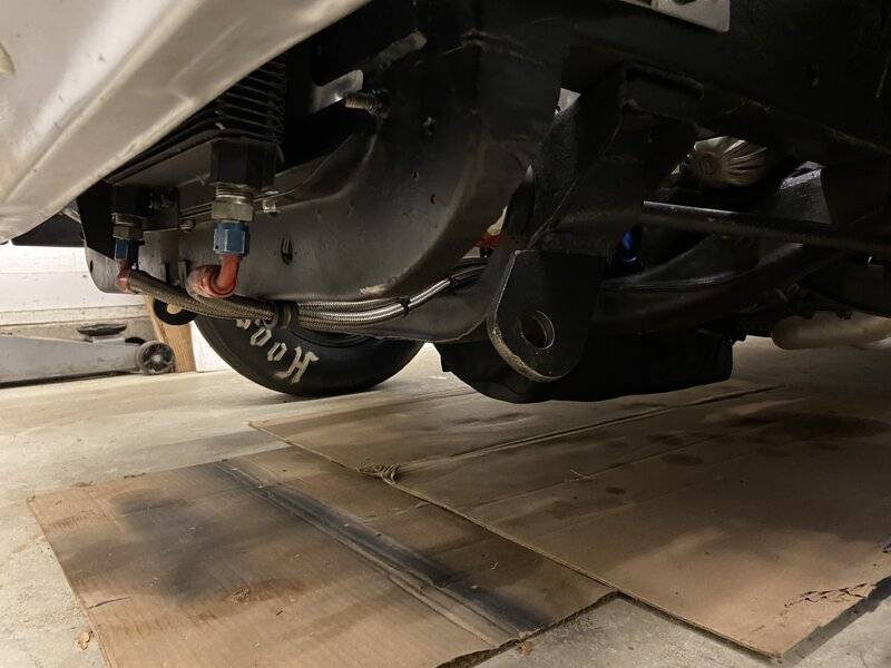

I have used the factory brackets see pic in the rear. The front has brackets similar to Mancini but thicker steel with no bending.
