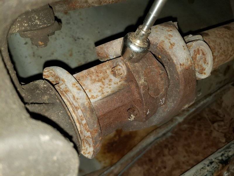

Im parting out a Dakota 4×4.
The front driveshaft is presenting some problems. The bolts holding the caps on the double-knuckle at the transmission end are siezed. They are a 7 or 8 mm head and going to round off.
Clearance is an issue & only a open/box wrench will fit on bolt. Do I heat the knuckle w a torch or just say F-it and grind the head off the bolt.
I want to salvagw the driveshaft as this Tranny is going in a different truck.

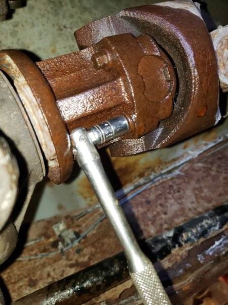

penetrate soak and heat works wonders on rusty junk
Yeah what Fly said...soak it good with some penetrant and come back tomorrow...
Put a 6pt 8mm socket on a 1/4" breaker.
Pound/shoehorn the setup onto the head of the bolt w the peen end of a small hammer..
Put some heat to the shaft side of the yolk and

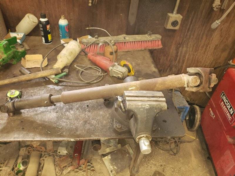

It worked!
Getting the setup off after breaking it lose was a pia. Do this 4 times and success!
Took 2 hours to get the damned thing out.
