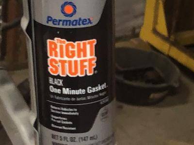

This stuff sealed up valve covers and oil pans when nothing else did.
Be warned: It makes the parts very difficult to remove later.

Yea I have never used it personally but that shits like the end all be all to sealing it up I hear. My buddy struggled to get his oil pan off after he stuck it on with that.......Positive though it didn't leak!

After some of the stories I’ve heard about Right Stuff and disassembly/cleanup I’m almost afraid to use it now. I’m sticking with gaskets and spraying them with a full coat of Permatex gasket sealant at the time of assembly. So far, so good.
