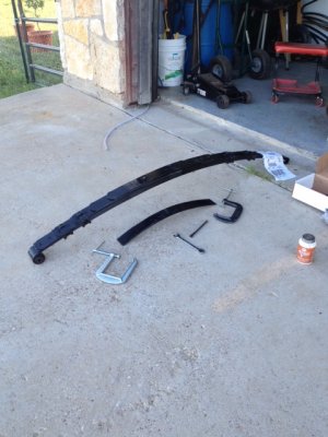

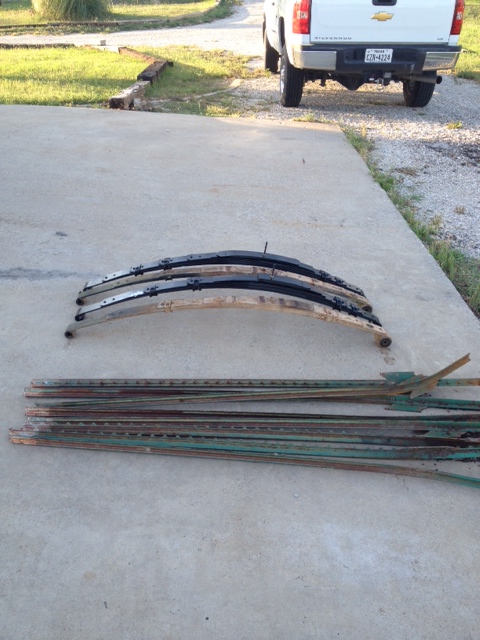

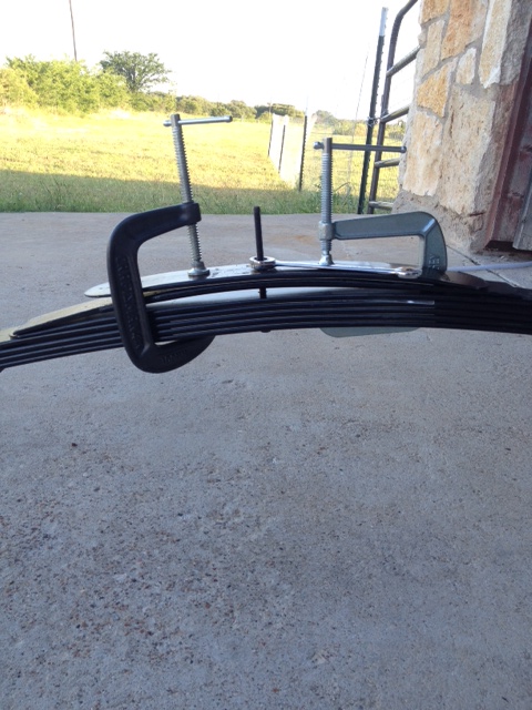

The add a leaf kit from summit was really easy to install – Ive read a lot of posts from guys doing it and figured Id give it a shot. For some reason my Factory Big block BEE has really chinsy 4 leave springs… it sat really low. They looked very tired. So I figured Id completely redo the entire suspension on the car. I went with the stock height XD (HD) big block springs from summit - but I figured I want a little more height in the rear and I read that these add a leafs would give me an extra inch or two. I wont know until I get it all back together and drive it a little. The majority of you all said don’t use shackles; so I gave this a try. Really easy – check out the pics photo 1 (1).JPGsprings 2.jpgphoto 3 (1).JPG. Thanks guys!

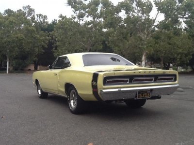

image.jpg Adding one Summit leaf each side got this result for me. Perfect.
Original springs. 1 inch and a fraction. Pictured with 225 70 14 fronts and 295 50 15 rears. 8 inch rear rims. No sag with beer and luggage. Triple digit handling not compromised.

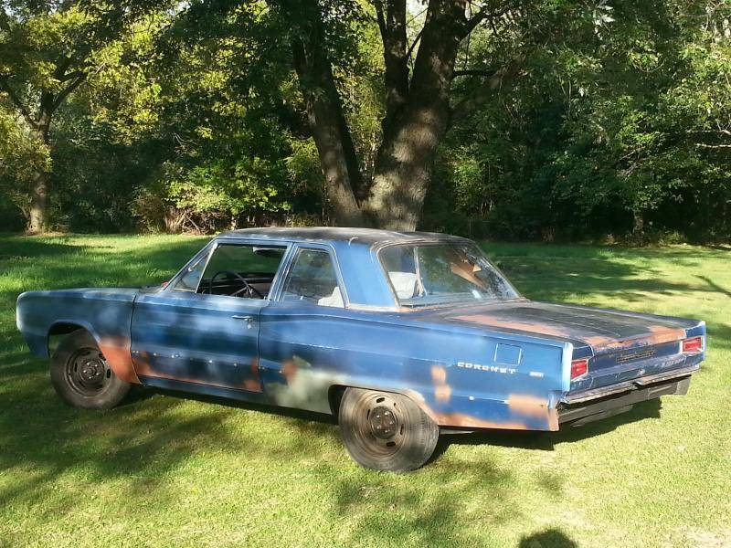

Best pictures I have from when I did it. I just took the second shortest leaf out of the donor spring pack and added it. Raised the back of the car up a an inch or two from its sagged spot and is stiffer but not overly stiff. Cost me like $5 for the centering bolts and that was about it. (well time and elbow grease to repaint them) Before I did this the top of the rear wheel was not visible
