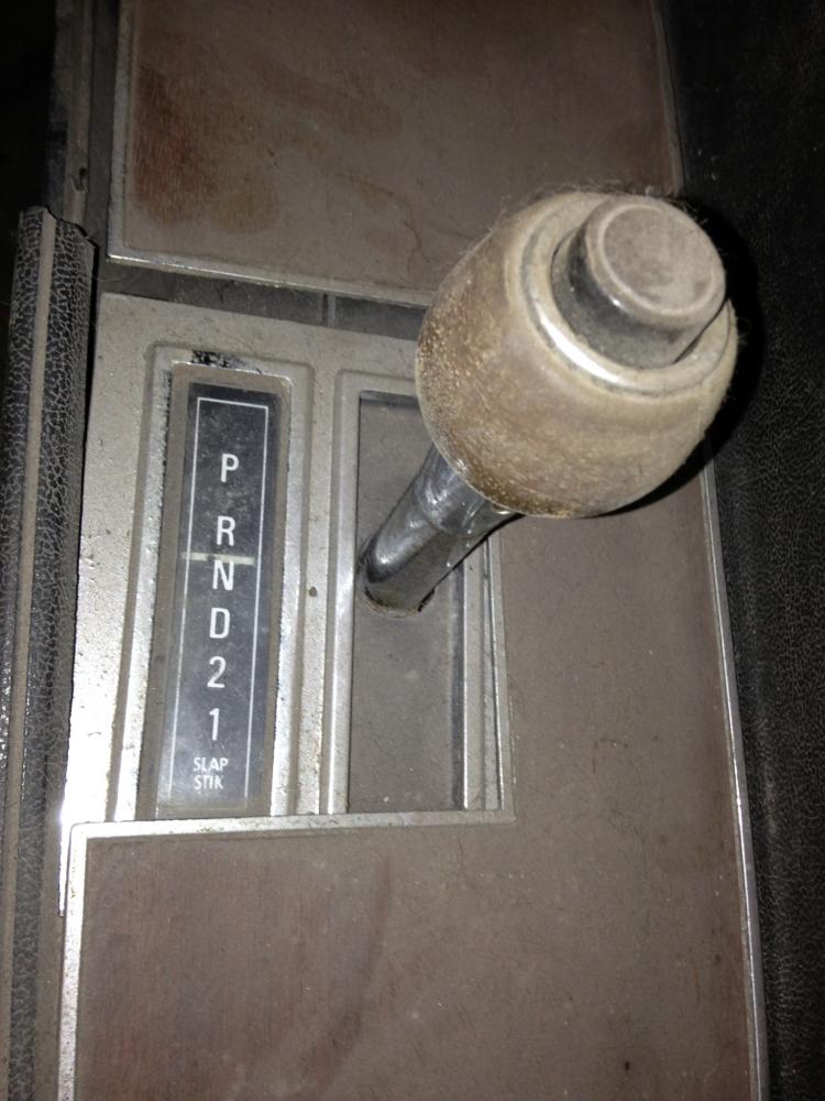

In my opinion, If it ratchets, it's a slap stik, whether it says so or not, since the intent is for you to slap it into the next gear without skipping one, as a regular selector would do.
I think maybe they realized they could get some PR/advertizing by actually calling attention to the feature with a decal/printing, afeter the first year or so.
Slap sticks are cool, with or without the sticker! When my son and I tore the Cordoba down we intended on installing an aftermarket ratchet shifter, we hadn't removed the console when my son said "check it out" and ran the gears. We pulled the console and verified it's a slap stick so it stayed.

Anyone ever seen a Slap Stick console with the colored sections for the different gear selcections? PRND21
My 73 SE Charger has the different colours under the letters, so at night the letters(PRND21) are each a colour
I thought they were all that way until the mid 70's.

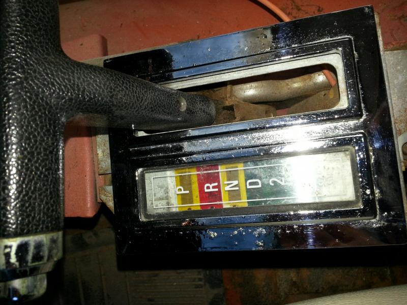

Here is a picture of the colored "Slap Stik" unit.
Anyone else know what they came out in?
I think I will use the colored section underneath my current set up which is not so pitted.
Anyone know if the chrome top plate can be bought new somewhere?

Looks like that's missing a part.
Should be a black plastic shield, so you only see the color where the indicator bar is.
Makes it look like the bar changes color in different positions.
...also covers the hole on either side of the handle.
The plate assembly with the rectangular hole probably wasn't original to a 70 cuda. 70's and most 74's have the round, brown ball.

Yes, the chrome bezel is in repro and can be bought new. Try BE&A or PG Classics.
I'm pretty sure that P&G classics made a repop of the chrome housing you're looking for. They are also available from BEA parts too. Part number 221. Around $95
On my unrestored 70 Challenger it has a round plastic shifter ball with a button that you depress to change gears. In 1971 all console cars went to the black T handle. That is also when they changed the flat plastic plate that goes around the shifter to a square type hole. The 70 had a round hole in the center and was a one year only application.
The black plastic plate with the square hole is also available from the above mentioned vendors, under part # 221-P71 and it cost $29 new.

As far as the actual part that has the colored segments, I'm pretty sure they are used on all B&E body cars that used a console for the following years:
1970 E body
1971 to 74 B and E body cars
The black plastic plate allowed the light to come from the console bulb and illuminated the gear shift indicator (and it really looks cool at night).
