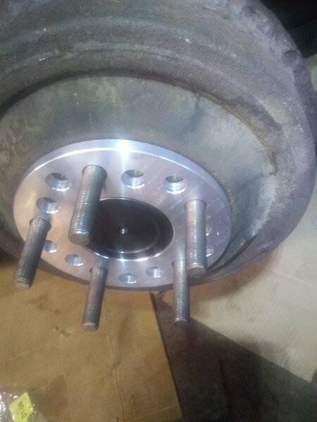

The 1/2 inch increase in backspace is the primary cause of your problem
Easily fixed with wheel spacers.
I much prefer too much backspace than too little. With the right spacers i can get the tire exactly where i want it.
