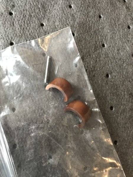

That broken nylon collar, is what keeps the whole mess together, and sets end play for the main shaft. (Doesn't need to be nylon. Don't know why they did that!) Easy to use another collar, that fits the shaft, and gives you the right end play. Too much, add a hardened washer/shim. Not enough, cut some off the collar.

It quite likely that the original "collar", used to control or limit the shaft's AXIAL or end play movement. The material can be nylon, UHMW (Ultra High Molecular Weight) Polyethylene or perhaps Delrin. The shaft is drilled during assembly and pinned with either a roll pin or spiral pin thru the shaft after the axial clearance dimension has been established. Just measure the THICKNESS of your old sleeve. Source a new sleeve of the same dimensions, measure the old sleeve's roll pin hole location and thru drill it using a drill press, NOT BY HAND. Perhaps talk with HALIFAXHOPS for suggestions or just send him the whole thing to rebuild. IN ALL REGARDS DO NOT USE PVC....ITS JUST TOO SOFT AND CANNOT WITHSTAND THE HOT OIL BATH it will receive during operation. The end play or axial play is important but not critical.....0.003" - 0.005" (+/-) should be OK....but never tight. Check yhe FSM for this dimension. Just my opinion of course.Would it be possible to make one out of a pvc pipe?

That lowly collar...I would never use a plastic one. When the builder of a new distributor installs the collar, pretty sure the pin hole is drilled, with the collar on the shaft. So, swapping collars, the pin hole could line up, or doesn't.
Try it each way it will go on. If no go, yeah, hardware stores carry collars, or pieces that can be turned into one. Guessing game on getting the hole drilled. Drill through one side, put the collar on the shaft, use the shaft hole as a guide, and drill the other side of the collar. It's not hard.

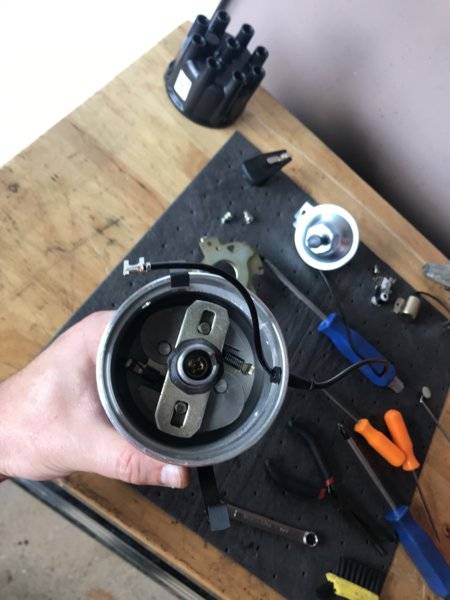

A rebuilt distributor...I'd tear the thing down, at least part way, check things, make sure it's lubed right, at the right places, and only then see if it works for you. No telling what moron assembled the dang thing!

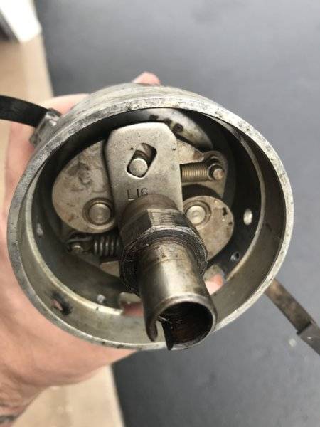

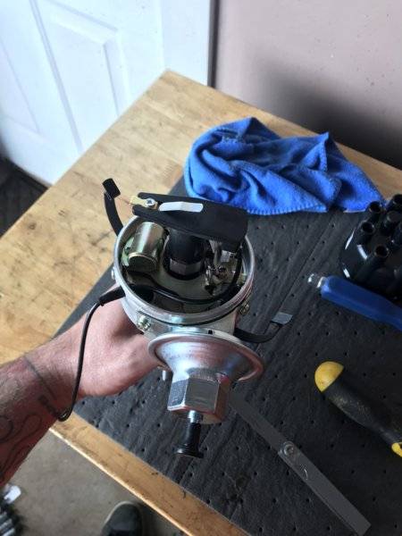

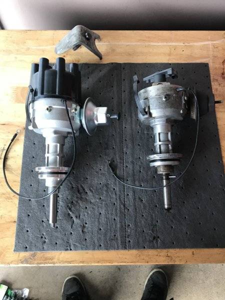

Here is a pic of the original distributor that was on the car it looks like it says “L16” or “LI6.” It is a single point distributor and the original one as far as I know. I got my remanned distributor this morning, the slots for the weights are angled differently than the original but seem the same size opening. I don’t know if the advance is different in the new distributor, I took the new one apart and checked the vacuum advance and put high temp grease on the specified locations from previous advice, haven’t had a chance to get it in the car yet hopefully Friday I’ll get it in and adjust the initial timing. Thanks everyone for all the advice and hopefully this fixes it, I’ll post pics of the new distributor tonightBefore you get too far ahead on this thing, something needs to be found out.
Right now, I'm assuming that distributor is the stock original to the car. Correct?
If so, first, know that it's probably a plain jane single point distributor. About as basic as you can get.
Second, is the 'amount', in degrees, of mechanical advance built into the distributor. That's set by the length of the slots, the pins on the advance weights moves in. Look in your service manual, and it should tell you, for that distributor, how many degrees of mechanical advance you have.
Keep in mind, the gas was different, back then. That means, the overall picture of timing, and advance, does not work with today's junk gas. It needs to be adjusted for it!
Look the upper shaft over, the two blades with the slots in them. Numbers or letters, and report back. There's several guys aboard, that can tell you right off, what advance you have, and give advice.
These Mopar engines go off of 34-36 maximum full advance. Knowing how much mechanical advance you have, and subtracting that, from the full advance, tells you what initial timing should be.
7.5 probably won't cut it. That's because today's gas, calls for 'more initial timing'.
But...you don't want to go over the full advance range.
Many times, on some of those non-adjustable advance distributors, the advance slots need to be shortened. Welding the outer ends of the slots, to shorten the slots, can be done. Then, filing to finish, and get both slots the same length, for less advance. You get the higher wanted initial timing you want. Mine is 14 degrees, 20 degrees mechanical advance.

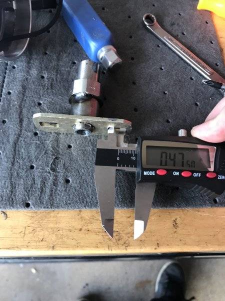

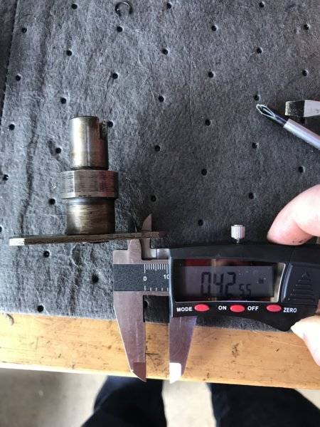

So does that mean the initial timing should be set at around 3-5 degrees btdc for the original distributor’s initial timing (ex.36-32=4) And for the new distributor I measure the new slots to figure out the mechanical advance from what you listed above then multiply it by two, and subtract that from 34 to 36? Sorry if I’m confusing itYour original is 32° mechanical advance (16×2=32°). Not much leftover for initial.
Grab some calipers and measure the length of the slots. See chart below...
Your doing fine. Probably more than you wanted to know! Your engine will thank you.And for the new distributor I measure the new slots to figure out the mechanical advance from what you listed above then multiply it by two, and subtract that from 34 to 36? Sorry if I’m confusing it
Yes and yes. If you know what total timing should be (say 36 degrees total), subtract it (36) from the mechanical advance to get your initial setting. If those slots are .490" long (16 degrees) then that is 32 crank degrees. 36 total - 32 mech = 4 degrees btdc initial.
Here is where it gets a bit confusing. Most engines will want a bit more initial timing. But if you increase the initial you also increase the total by the same amount. Say you try out more advance, maybe it likes 12 degrees btdc, now your total ( 12 initial + 32...
Ok so not sure if all the readings made me more confused or not but here’s some pics of the new distributor measurements for mech advance for the new distributor which was .475 which = 15(x2)= 30(36-30=6) so if I’m understanding correctly, when I put this particular distributor on the car my initial timing should be set to 6 degrees btdc so that my total timing advance equals 36 degrees? The original distributor mech advance measurement was .425=11.5 (x2)= 23(36-23=13) which means 13 btdc would be initial timing for that old one, is this correct? Sorry if I sound like an idiot, I’m a Marine and need to break it down Barney style hoping to get this thing on and running again today or tomorrow. Thanks again for everyone’s help.
