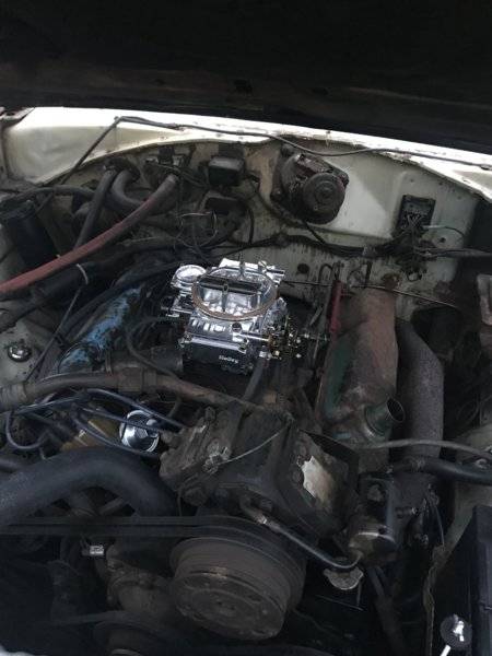

*update* think I’m finally out of the woods, bought a new Holley 80457sa carb today and put it on the car, only adjusted the idle mixture screws slightly and probably need to fine tune it still but the hesitation is finally gone. Still need the correct spacer but it will work for now. Can’t thank you guys enough for all the help, knowledge and patients you have given during this whole process I really feel like I learned a ton and know my car even more now. Thank you guys! 394C49AF-276E-49E5-B5CD-7D7FDAEA4608.jpeg
