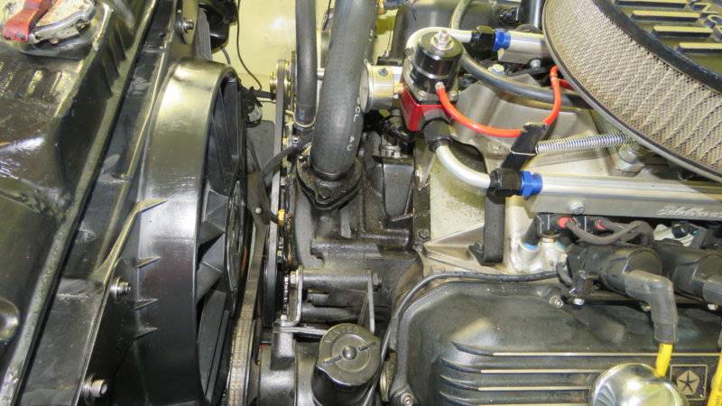

What else is going on with the engine? I see fuel injection, I see NO distributor cap but individual coils....cool stuff!
Well, I built in my basement a new engine all computer controlled. Based on a 400-block a 512 with 12.4 static compression running only on E85. Stealth heads, M1 intake converted to port injection. Billet steel main caps, and girdle...(originally planned a double turbo engine...but time and costs made me change my plan...).
Old distributor is converted to a home-made cam sensor, 36-1 trigger wheel welded on the crankshaft pulley. All is home-made computer controlled by MegaSquirt MS3X...port injection, 8 coils (GM LS2 !), electric cooling fan (Volvo V70) and cooling pump (Australian pump, Jeep drive electronics), both computer controlled variable speeds depending on cooling requirements. Beefed up 727.
The engine is very powerful, spins effortlessly rear tires from low rpms. Currently running sure grip 2.93 rear, but will shift to 2.76 and 15 inch wheels since I frequently do long trips. I don't expect the shift to have any significant influence on the tire spinning...
For the future it would be nice to have MS3X control both the throttle and the 727...
