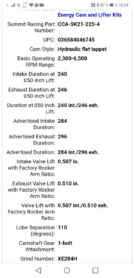

No cam info. What cam is it? What rocker arms? Did you degree the cam?

Yes I degreed the cam straight up I believe at 107 degrees (3 years ago if my memory serves me right)
Adjustable rockers set at 1/4 turn.
Using the recommended valve springs.

E street heads have approx 320 spring pressure. Thats not too much for the lifters and the cam is plenty at 507 lift

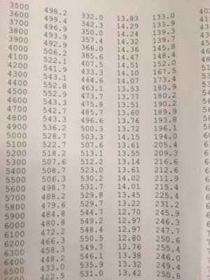

My suspects are either that I've reached the limitation of the cam/lifters or maby the ignition box.
Might just upgrade to a solid cam and a new ignition box this winter

Your heads, cam and setup is giving you the max effort.
You wont find any more power with that combination.
Dont waste your money on a new ignition box.
It is what it is.
