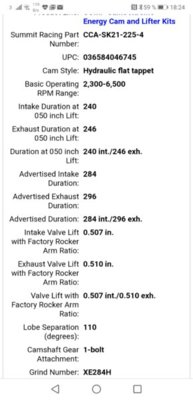

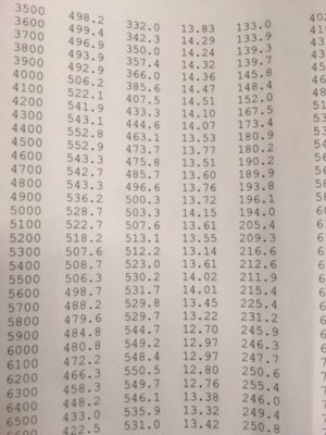

I believe my car has 11.9s in it without nitrous, but it just feel slow after 5000rpm during racing so I just shifts around 4800-5200rpm. I can't figure out why?
Any ideas?

Yes I degreed the cam straight up I believe at 107 degrees (3 years ago if my memory serves me right)
Adjustable rockers set at 1/4 turn.
Using the recommended valve springs.
Msd 6a with chrysler electronic dizzy and msd anti vibrate coil.

E street heads have approx 320 spring pressure. Thats not too much for the lifters and the cam is plenty at 507 lift

These heads have been cleaned up with a light bowl work, gasket match and back cut valves.
They should flow enough to support 500-550hp i think
My suspects are either that I've reached the limitation of the cam/lifters or maby the ignition box.
Might just upgrade to a solid cam and a new ignition box this winter
It’s not likely the MSD 6A.
The solid cam should cure it.

Your heads, cam and setup is giving you the max effort.
You wont find any more power with that combination.
Dont waste your money on a new ignition box.
It is what it is.
