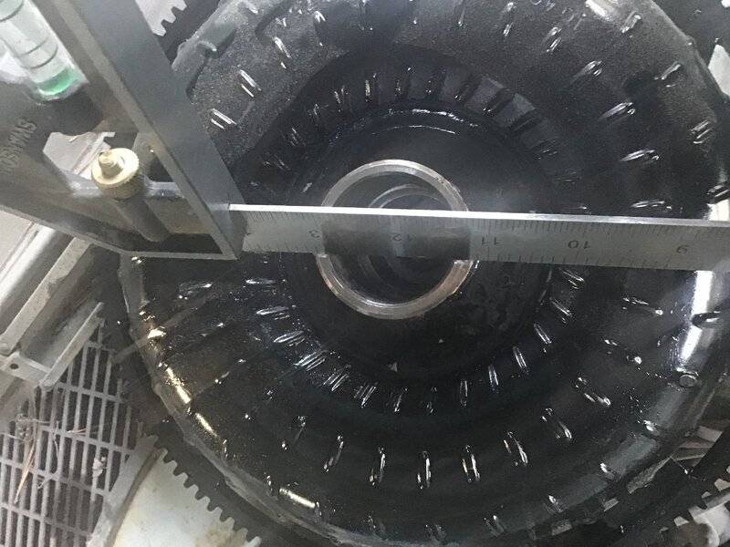

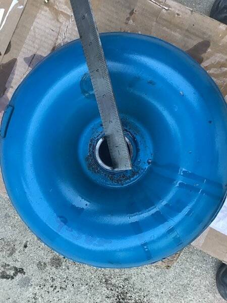

So I bought a 408 stroked 360 from Performance Injection Equipment during the heat of COVID. Had them add a TOrque converter to the build……
After a little while I’m finally installing…. Trying to put the TC on the stock sb 727 it looks like the shaft on the TC won’t go over the splined transmission shaft into the trans… the stock shaft is about 1.5” and my new custom TC is 1.75-2.
It’s rated at 482 hp and 530ish torque. How long do you think the stock TC will hold up if i reinstall?
Any advice? Is it the wrong TC? Big block maybe?

The black TC with the bigger shaft is the new one. The blue one with the smaller shaft is the stock…..

I can’t even get the TC to enter the transmission seal area. 1st step if you will. If it’s supposed to be tight I’ll do it again with more force, but because there is a 1/4” size difference I’m thinking it the wrong TC.
Blue one IS a 904 Convertor
Aftermarket on IS 727
NOT COMPATIBLE!
You have a 904
Sorry to be the bearer of Bad News = They will NOT work together!
You need a 904 Convertor
Might be cheaper to get a different convertor.
