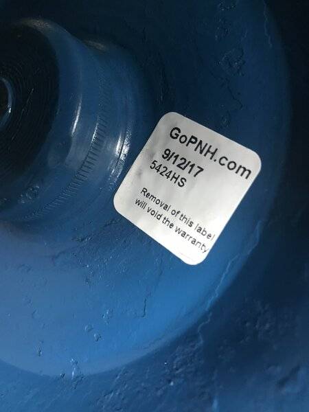

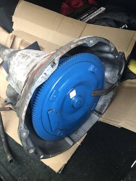

I have a 70 b body 440 with a A727 and a 2000 stall torque converter. When I nail it from a stop, all is good. Quick and great shifting thru the gears. If I’m doing 45mph, and I drop it into 2nd gear and nail it, the car falls on its face for a second or two. If I ease into the throttle it’s better. Could this be a TC issue? This has happened with different carbs, fuel injection, dizzys, timing etc. should I go back to a stock TC? Not a race car.

Never had a stock one. Swapped small block with big block and trans rebuild guy selected this one.
