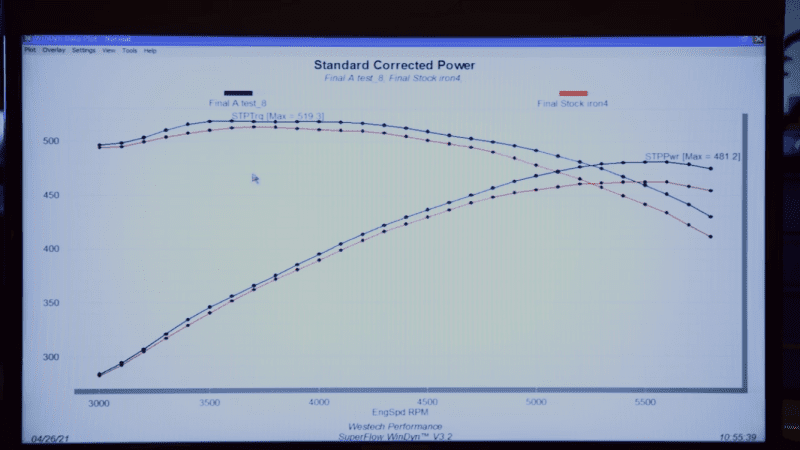

I can’t comment on headers, but the Holley street dominator is a good choice, I’ve heard good hood clearance too, here’s a dyno chart eddy performer in red vs the Holley in black. My GTX is a stock 350hp 69 Chrysler Newport 440. I have 440 source heads, offy intake, and stock hp manifolds. It’s not a giant stroker, it’s the stock cam, not an ultra thumper magnum race cam, but it’ll burn rubber and go fast, what more can you want?
