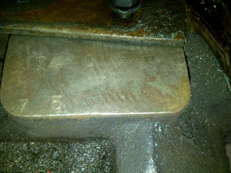

I've always read about that but even after tearing down dozens of big blocks, this is the first time to see it!
Cool, then the block pad should be stamped with the maltese cross. That denotes under sized factory bearings.
Yup....started messing with cars in the late 60's and parted lots of Mopars and Mustangs during the 70's and built lots of engines and rears. I still have a 1970 standard bore passenger car 440 (and several 400's) that has been sitting on a stand for about 15 years lol. Don't know why I saved it but I did....From your posts, seems like you have been around and yet this is the first time you actually are SEEING real hard evidence, if you will. Exactly my point.

Mt 1977 440 smog motor has no maltese cross on the block pad. But 1 rod does where the numbers should be. And all the other rods have a symbol on them, rather than number 1 thru 8. Did yours have a windage tray, 9155? Mine did which really was a good surprise. And it had the factory double roller timing chain.
Also these 70 and 71 pistons weigh in at 860 grams, and 803 grams. The pin is 190 grams. The KB 237 piston weight is 775 grams. Thats alot of weight changing direction 100 times a second at 6000 RPM! Thats one reason I went with Ross pistons in my 451. They weigh 550 grams. But I think you will have a great performing street motor with a light re-build. Good luck.

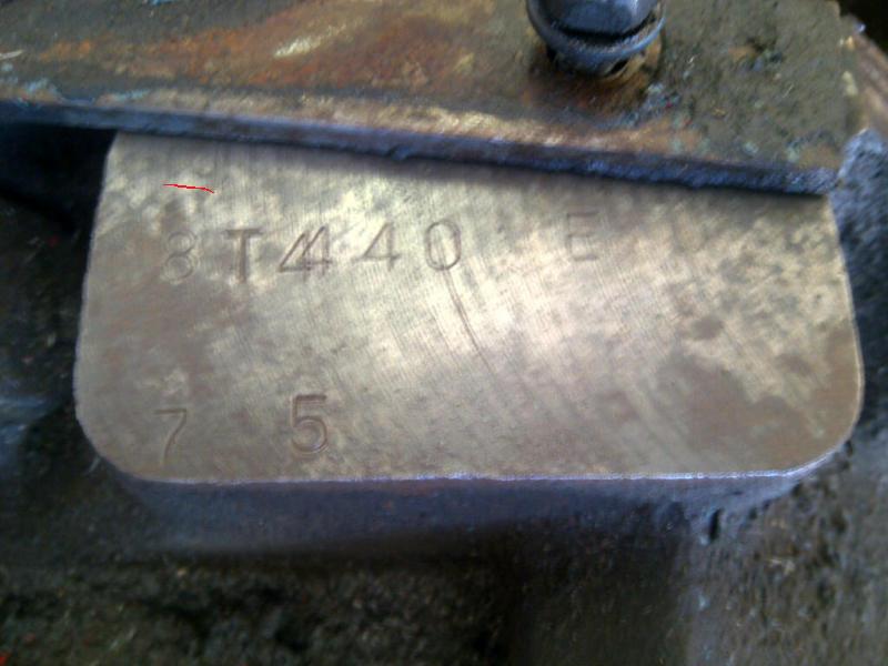

What's that just above the red line? Looks like it could be half a maltese cross from a poor stamping.
great eye you old rusty sponge bob croc wearing mopar freak!
Ill go clean that up more and see.
It definitely looks like something!!
