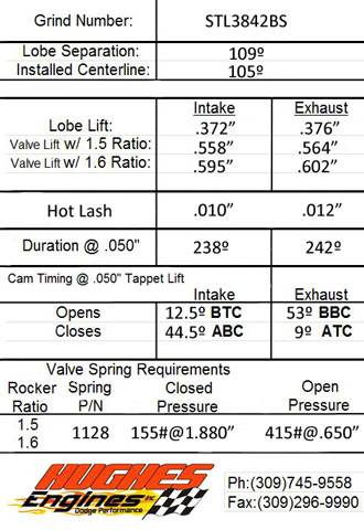

Here are my cams specs...I'm running 1.5:1 rockers.
Yea no biggie......we are close. You run a bit more lift and I have a bit more duration, and my cam is on a 110 lobe separation and yours a 109, so we should be in the same vicinity. You run the solid cam though right?

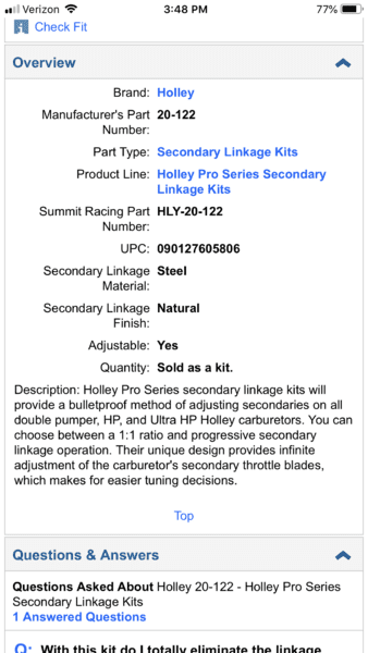

Wow thats a very low idle you achieved! What are or is progressive linkage? Is that a non linear throttle linkage? If so how?
Progressive linkage is where the secondaries only begin to open as you move through about 1/2 throttle, give or take..there's a point where you can feel the linkage grab the secondaries and start to open them. It's very subtle, and it may depend on your throttle cable stiffness and such but in something like a big block that makes a lot of torque, you can cruise around town without ever really opening the secondaries(what fun is that though!).
The way they work is the carb throttle levers are slotted a certain way and the small arm that connects primary to secondary is bent in a certain way to allow some movement of the primaries before cracking open all four. On my particular carb, you can switch the rod around to run 1 to 1(all four barrels operate at the same time) or progressive style
Got it nice. Looks like they make one for the 4150
