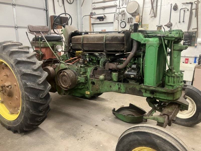

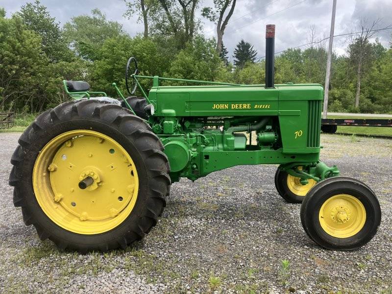

Grew up working John Deeres and Oliver’s. Have a few, and one currently doing a restoration.

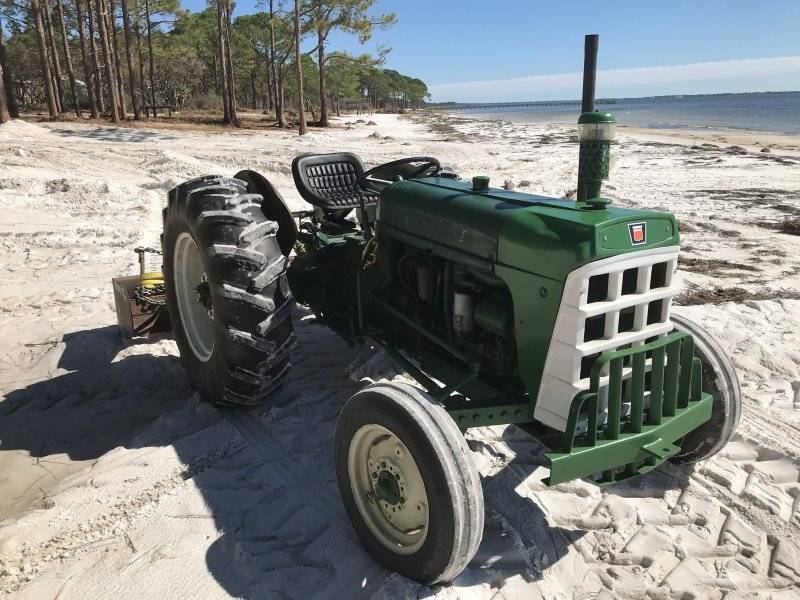

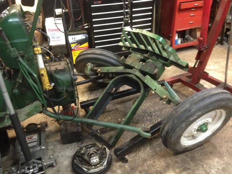

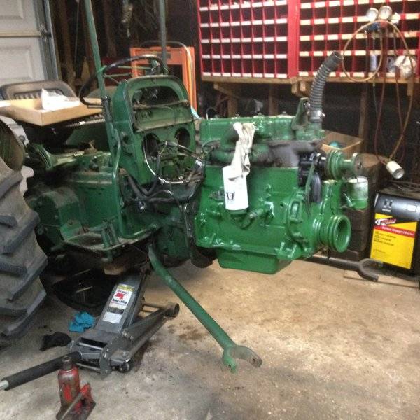

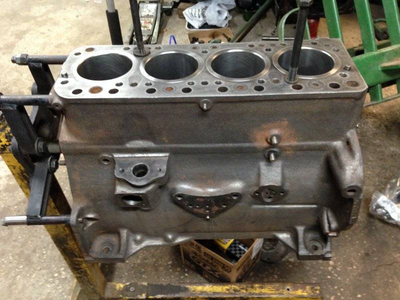

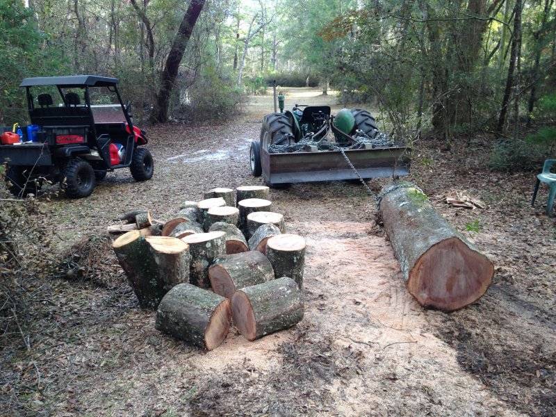

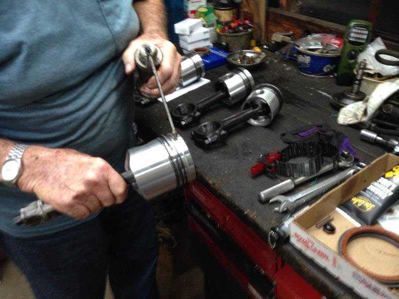

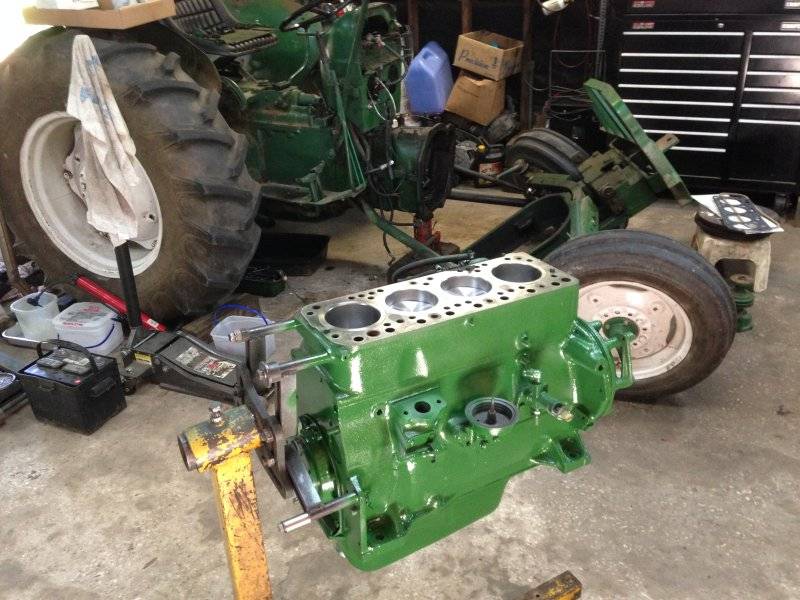

 I can see that floor jack sweating from here. I bet it said uff da when you put the frontend back on!I bought this 64 Oliver 550 Diesel 15 years ago to grade my non county maintained road. Z-split it 10 years ago and re-sleeved it and went from 145ci to 155ci because they no longer make the smaller version kit. All new clutch, throw out bearing and all seals. Oliver had a Dealership in Marianna Fl. to the west of me and was the farthest south they ever got. Lots of them still over there on farms. Even had it down to my friends beach house after hurricane Micheal in 2018 to reclaim the gazebo I built them in 2007.

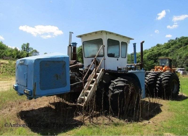

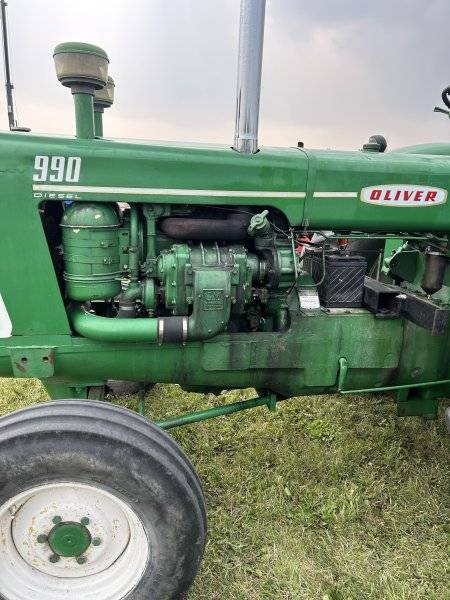

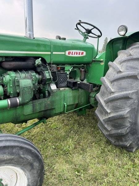

Here's something you might not know about that Detroit that's in that Oliver. That's a left handed engine. It runs backwards. You can tell this because the blower is on the left side of the block. Most normal Detroits had the blower on the right side. Back in the 50s - 60s the old buses (Greyhounds) used left hand Detroits because the engine was behind the axle (regular axle just turned over with yoke in back) so they needed it to turn backwards to make the bus drive right. The blower and the cam are both different for that engine to run backwards. Probably if you can remember the starter mounts from the back on the engine. I overhauled a bus engine (6-71) that was one of those left handed engines many years ago.This is a stock Oliver with a Detroit diesel, I believe 2-cycle diesel. Can’t imagine being in the field with this 8-10 hours a day. Apparently you have to these maxed out as they have a hard time recovering. I go every year to watch this tractor. Hurts your ears.
