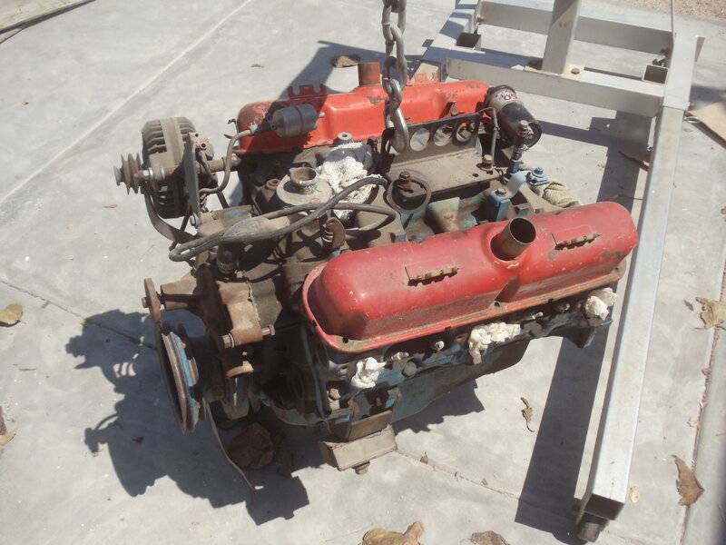

I have always found old rubber mounts on the verge of splitting in two. The driver's side always has a separation/crack which could let loose at any moment. Don't trust 'em. On the bright side, purchased an '85 Olds Cierra at a discount which had a terrible vibration (owner said the auto transmission was going out). Got it home to find the problem was only a busted motor mount!
If you enlarge the photo of my 318, you can spot the crack/split already visible on the top of the rubber motor mount on the driver's side (only have about 2,000 miles on the little motor).

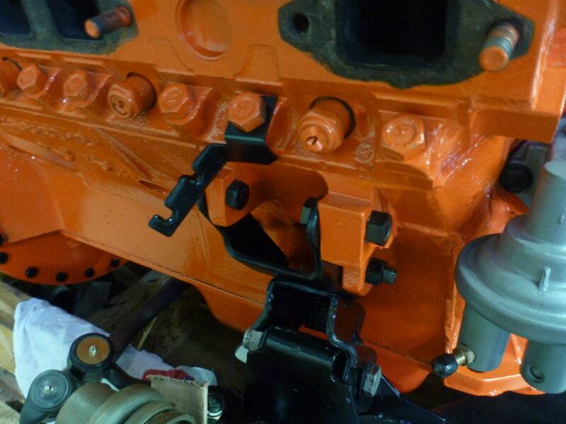

I've run the same solid mounts and a rubber trans mount in my 4 gear Bee since '79 as got tired of tearing up left side mounts. Never noticed any vibration issues, but maybe I just don't know any difference! LOL.. Well actually I do, the Bird has it's OEM rubber mounts, with it's Automatic trans, and both cars "rattle" about the same.
