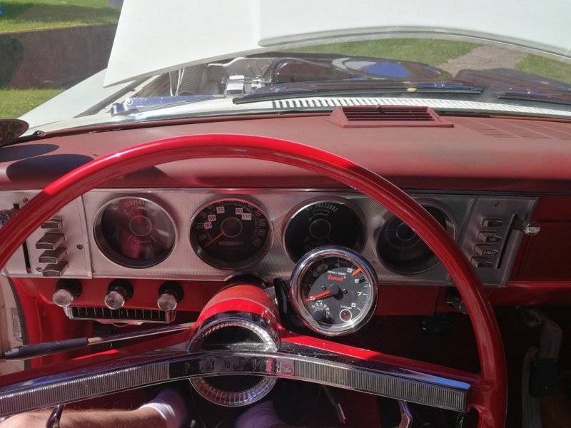

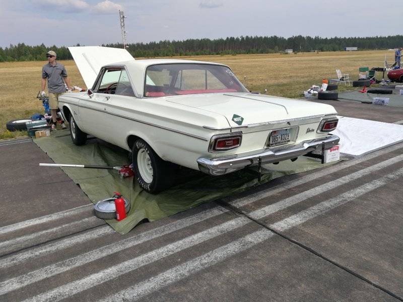

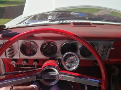

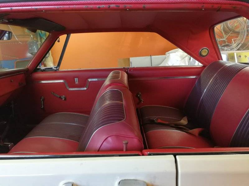

Some pictures of the car might be fun to se fore some people

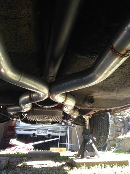

I think opening the headers at the track would be pretty high on my list of things to try.

Nice looking car!!

I have cut outs that will be installed soon, so I will try that.

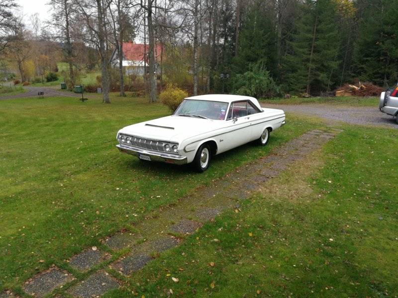

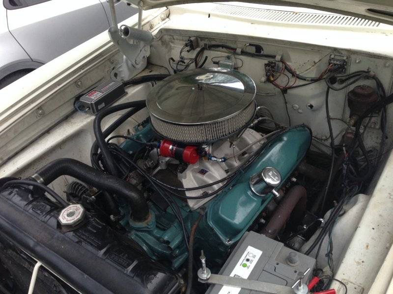

Thanks, trying too keep it as stock appearing as possible.

There’s a cork... I’m used to 2-1/4 primary tubes and considered my 3” exhaust “small”.. we dropped it and picked up mph.

And the details matter too. Age of the exhaust, compression or mandrel bent, 2 1/2" verses 2 1/4", tail pipes? I had a shockish 440 running in 104 to 108 mph range, and those things did matter. It did go almost 109 mph with full length 2 1/4" mufflers and 2 1/2" compression bent pipes. Wish I would have done a test with all 2 1/2" mandrel bent exhaust and mufflers. Don't know if it would have been worth 1 hp, or 20 hp.

Full length mandrel bent 3" exhaust, dual chamber mufflers that necks down to 2-1/4" inside. X pipe
