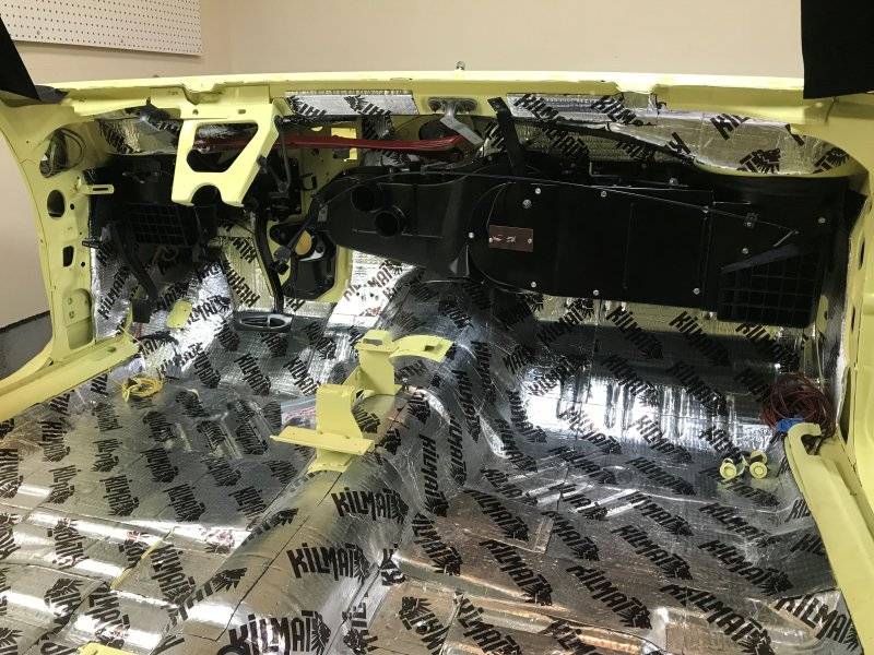

KILMAT all the way. Best bang for the buck. All brands are essentially foil lined butyl. It's not rocket science. Duramat, etc. are just ripping people off.
Before I lined a roof I did a variety of heat tests with a heat gun and a torch on a scrap piece of metal. The heat made it stick harder. We have used it on three builds now. Good ****.

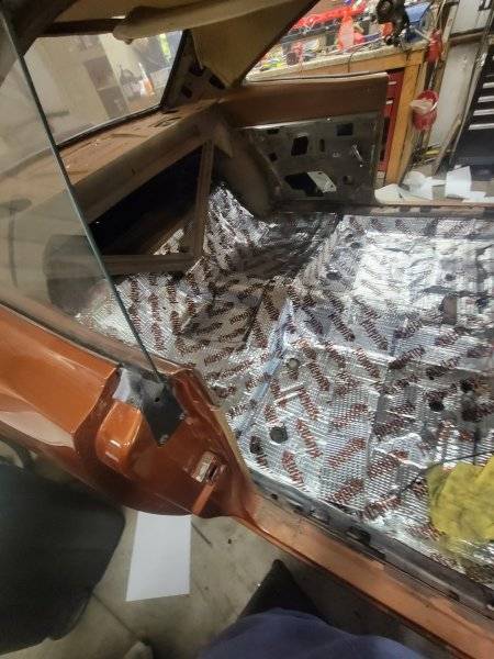

I used 2 full boxes of 80 mil. and had a couple of squares left over plus the trimmings. Was able to do the roof, firewall and floors, didn't do the doors or quarter panels. I sprayed the inner doors and quarter panels with body Schults from 3M kinda like the factory did.
I guess if you want to do the doors (and quarter panels?) you'll probably need 3 boxes... maybe go with the thinner (50 mil) on the doors and quarters?

I would buy a box of 60 and a box of 80 and go to work. The 60 works a little better in tight spots. We used 60 on roofs because the thought was that it was a little lighter and less chance of delaminating. My heat test debunked that thought. As stated above, heat makes it stick better so why not do 80 all the way around.

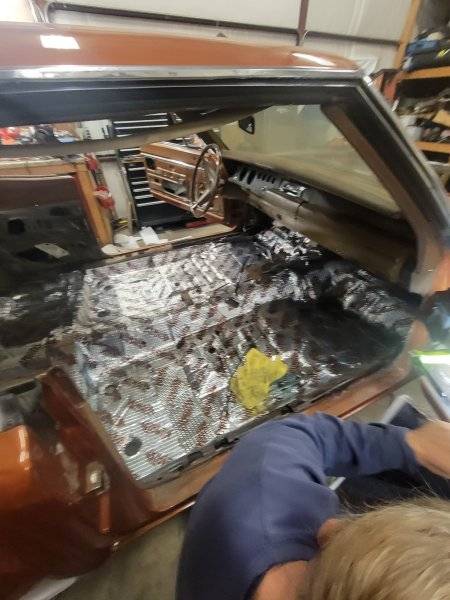

I did the firewall and floor of the GTX with FatMat early last fall when I replaced the carpet. Then I installed ACC mass backed carpet which has considerably more material thickness than the 23 year old ACC carpet it replaced. Interior resonance was noticeably better. If it helps to reduce interior temps in midsummer, it will be well worth the effort and expense.
