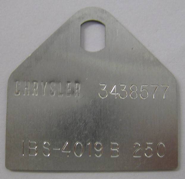

I have seen those and don't like them 1, to expensive 2, they are engraved not stamped and it shows. Bill Rork? stamps them for 35 each shipped and look perfect. Had customers get them for clones. I will not physically put them on.
http://www.billrolikenterprises.com/

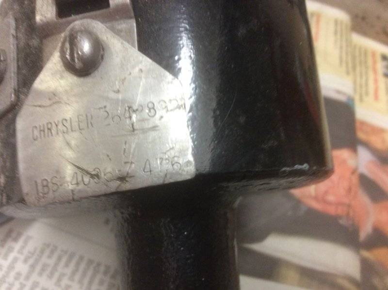

Originals get beat up. 2642899 lower leg on 9 missing, poor stamp. 47 th week of 66.
That's the way I get them in all the time. Sometimes they are rotted out also. Most of those become parts distribs and I just strip them. the rotted tag ones.

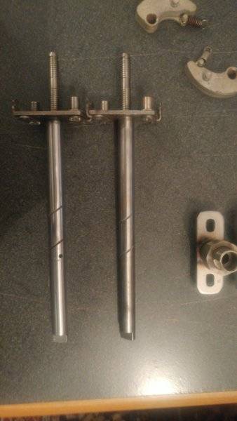

Sorry I missed this and late to the party. :D First, from reading thru all this: USE a 9/16 Tap to thread the old bushing and use a threaded bolt with about 4" or more of thread (or a rod) to pull the old bearings. Find an old dual pick up emission distributor and use that shaft to install bushings.
That 4006C was a Single Point Distributor for a 413. It used the IAZ-1039 LA shaft. Which obviously work for a RB and I have one, but being single point, the tip slot is clocked to a different setting then a normal DP Shaft. It works, you will just have #1 plug wire at a different spot, and might have to orient distributor for timing in a slightly different spot. Hopefully no interference with the vacuum advance.
The only true spare shaft I have is a NOS Super Stock shaft for the the 64-65 race hemi and I am not selling that. I do have the shaft for the 4006C if you need it. Obviously makes the distributor useless without a shaft:).

It will work, Just swap shaft over as long as it is straight and not worn out. You CAN NOT use that cam stop though. The diameter of the cam is smaller and meant for SP only. Used the 383 DP version you have. What Letter is stamped on the cam stop top, and what letters are on the bottom of your orig? Should be L? to be a CCW RB version. What is the Shaft part number of your original. I can not make it out in your picture. But looks like L3 something. The 383 shaft is L36 and a RB block is L39.
The bearing you got may work. You can down load and or view a service manual on line. The electrical section gives you all the spec needed for rebuild. Normally with a 5lb pull on the shaft the spec is .006 deflection for a rebuild. I think those bearing you got may shrink some when pressed in. THe ID spec was .4995 to .50, and the shaft is .498 so about .0015 to .002 clearance for a new install, but that will not give as large a deflection since in a shaft that clearance on one side is half. You also can clock the distributor and oil pump drive shaft to help get the distributor orientation you need to compensate for the tip clocking of this new shaft your getting.
