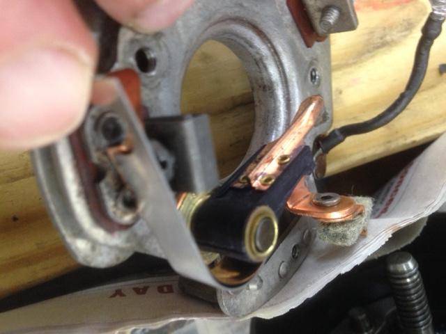

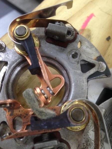

Interesting - received one set of points today. Look OK but the spring ends seem to long and extend past the screw securing in the slots.
They can be made to work but suspect may not be right - not sure. See what the others look like when I receive them.

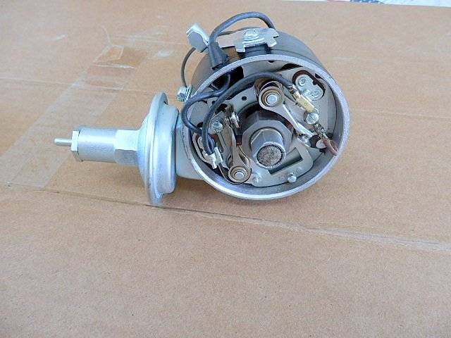

Nice have to love them!Finally got around to stabbing my rebuilt DP Prestolite distributor in the GTX yesterday and it's doing it's job. Looks like cam stop is allowing about 22 crank degrees advance so set timing at 14 with my dial back timing light. Much better unit than the rebuilt aluminum distributor that dropped 2 degrees dwell when ever the throttle was suddenly opened and vacuum advance came out. This thing has rock solid dwell no matter what you do with the throttle. All this won't matter much on my stock 440 but it reminds me what a quality distributor these Prestolite distributors were.
