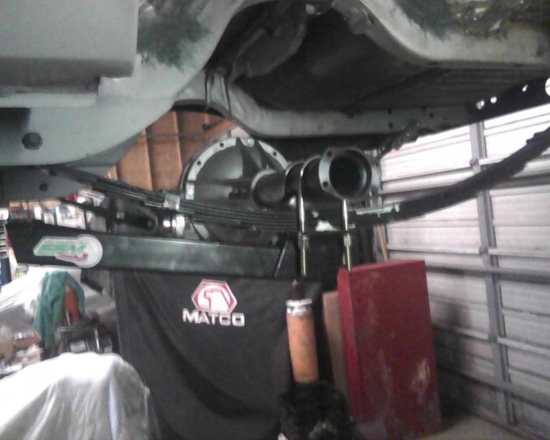

qc1.jpgAnyone ever use southside traction bars ?
I have a set with my new SS springs and was wondering if thay will work good for a pro streeet set up ?

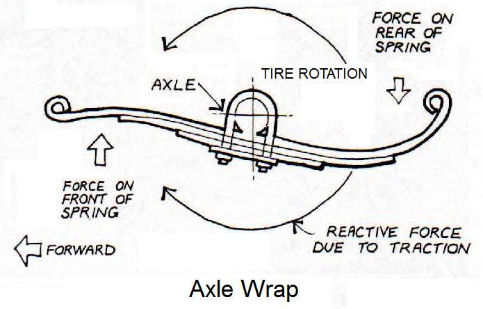

I've never seen anyone I know use them... BUT with the S/S springs shouldn't need anything except a adj. pinion snubber, if you got the room anyway... I see your photography skills are about as good as mine... he he ha ha... I see allot of Mustangs & Camaros use them, when I did a google search... South Side Machine "Lift Bars" is what it looks like you have the traction bars are just like most all others, seems the GM & Mustang guys like them, I've never used them...

Yea I got my geomitry down and I am going to modify the front with an adjustible snubber. I don't have the provision to use a pinion snubber with my QC rear. So this is what I am thinking of useing to control axle / spring wrap.
I use to use this type bar on my 69 stang for drag racing and thay work real well. So with alittle tunning I am hopeing to get them to work on the runner.

Yea I like the Cal-Tracs but to costly for me at this point. With these hitting rite under the front spring eye thay should plant the rear down just rite.
Also running a 50/50 shock to help pull the weight of the body down.

From experience with early Mustangs, 'slapper' bars work pretty good. And you have the right idea with them making contact with the eye and not behind it. I've seen so many people use the one size fits all traction bars with the rubber bumper contacting the spring behind the eye and that will bend the spring. What kind of a rear end are you using?
