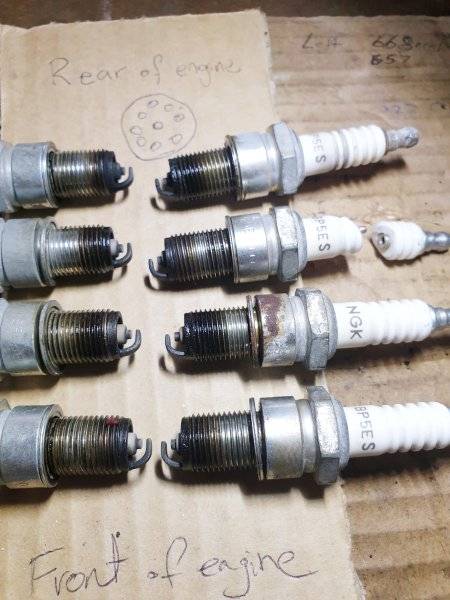

My 318 in a '72 Satellite developed a miss in the lower rev range. Upon checking the plugs I noticed one was cracked. I took it out and it disintegrated in my hands. I decided to replace them all (NGK BP5ES) to NGK GR4 V-Power plugs. A very noticeable difference (in a good way), hot starts are instant and the misfire is gone.
Broken plug could be the result of not having a rubber in the plug socket. (Yes I said rubber)
A crack in the porcelain will allow the spark to jump outside to ground.
