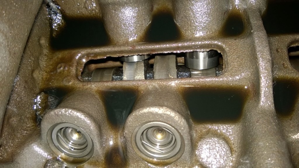

Nope, I see lobe (*relieved*):
Pretty apparent that particular lobe hasn't worn quite the same as the adjoining ones, though. The pattern isn't as shiny and well-defined as its' neighbors.

You see the pics - the lobe and lifter look like the others to me, anyways.

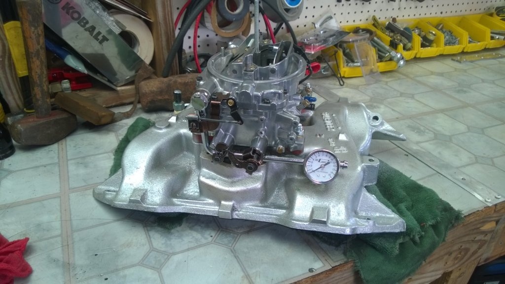

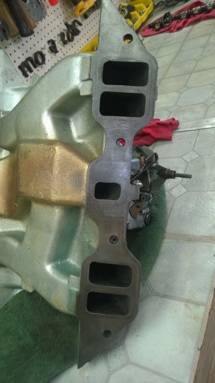

Cleaned up the intake gasket surfaces on the factory weighs a ton intake...
Gave the intake the ol' shot of silver. What the heck.

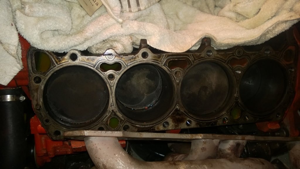

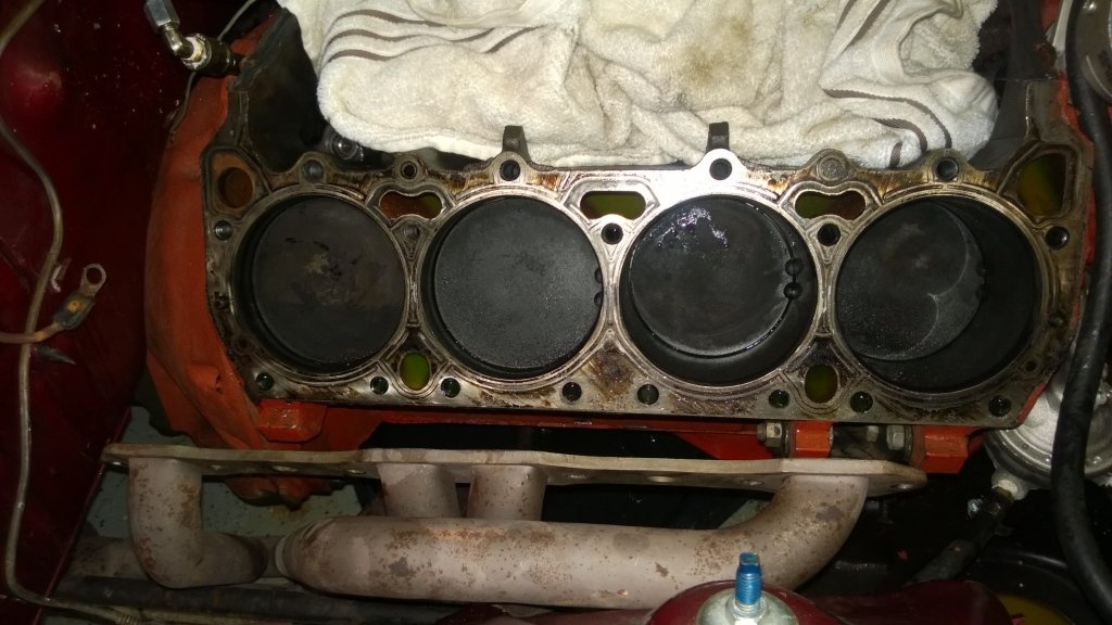

Drivers' side head is off. Cylinders not scored up that I could see. Mopped up antifreeze and took a pic. Flat top pistons, way down in their bores (looks like the top ring is getting within 1/2" of deck; what's that mean the piston tops are getting to? Nowhere near high compression, I'd bet.

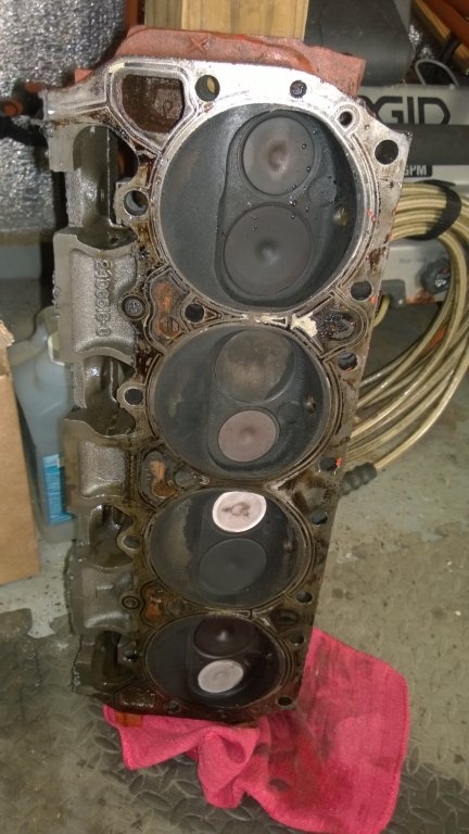

Drivers' side head. Ghostly exhaust valves are on #5 and #7. Coolant getting in there?

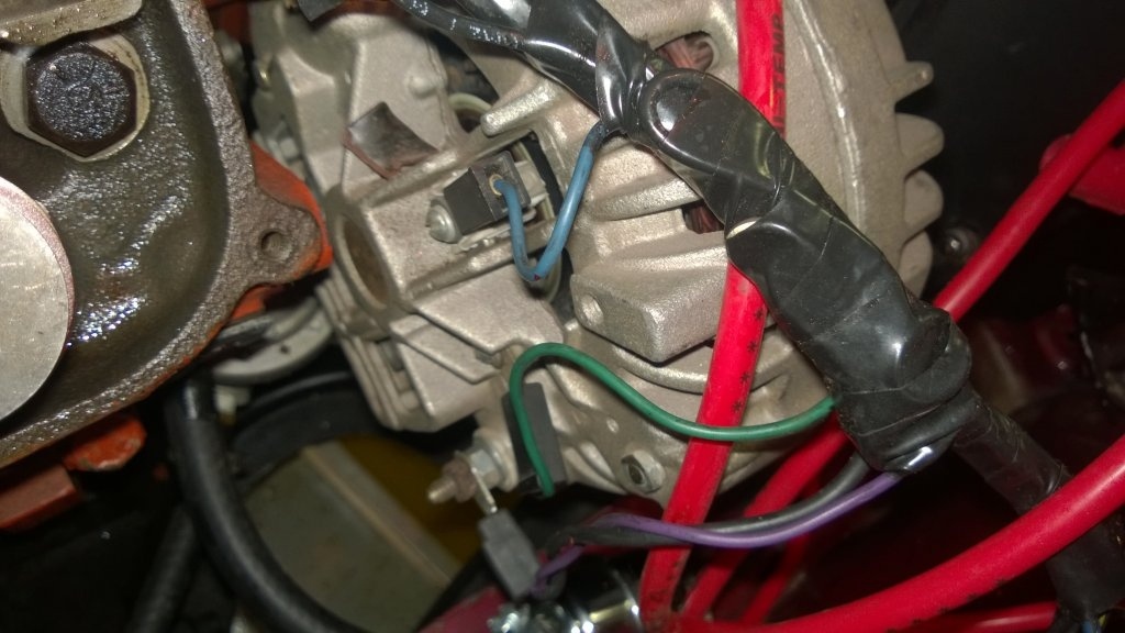

Taking note of wiring so I don't have to remember it later...

Similar hodgepodge to drivers' side, least to me. Cylinders feel smooth, top ring only getting within about a 1/2" of deck.

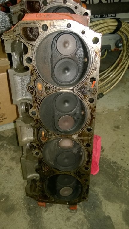

Passenger head. 3rd intake down is the one that bent the pushrod. Obviously something weird has been going on in there.

What do you all see in these pics? Any reason I can't just reassemble the engine with the 906's? Any helpful hints on procedures or such?
I get the feeling I'm going to get one shot at this; I'd just as soon do it right.
