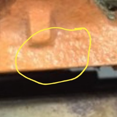

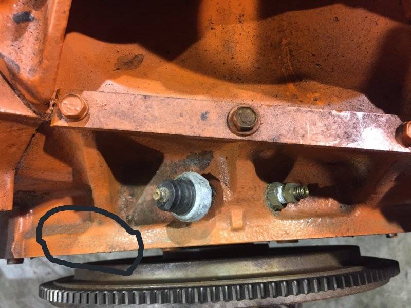

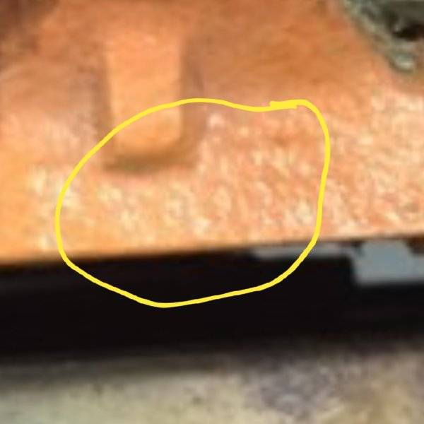

Based on your August '68 casting date and only a revision 8 block casting vs my revision 12 from Feb '69 I REALLY doubt your engine is a warrantee replacement. You either have a late '68 engine with VIN stamped up on top rear, or someone ground the old numbers off. I don't see any evidence of milling cutter marks on that pad.
so 200249 and 120309461 means Jan 20 1969???
The "120" means January 20th - correct.
I agree with this statement and if I enlarge the photo you have of the bell housing flange, you can almost make out a faint number stamped in the location where 1968 engine blocks would be stamped. Does anyone else see this or am I imagining it?!
Finding what is stamped on the distributor pad should tell the story. That is the missing piece of this puzzle...
The area that PP1RT circled is the area I am referring to and is about the same location as where my 1968 block was stamped...
