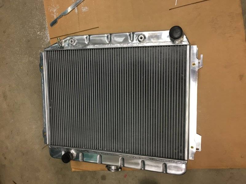

Went for a 40 mile cruise around town trying to break it. I think the temp outside today is low 80s. Can't say it cools any better than the old 3 row champion without shroud. Temp gauge always showed 180. We will see this summer.
I did test the shroud. I placed a business card at each corner of the radiator while idling. It stayed in place, so I know the shroud is working.
As I expected the transmission line fittings are moist. I'll try to tighten 1/8 a turn when it cools down. Probably try Teflon tape next.
I'll update the thread later with a video.

It looks as if I have a radiator leak, but can't prove it. Between the petcock and transmission fitting I have some coolant. Not enough to drip, but constantly wet.
Borrowed a really nice snap on coolant pressure tester from @JimKueneman and pressure tested at 13psi overnight. No leakdown on the gauge, no drips, but moist to the touch in that area between petcock and transmission fitting.
Called Frank at ECP and he said to drive it awhile and assured me he will warranty IF I can prove the radiator is the cause. I may replace the petcock as a last ditch effort.
Not sure where to go from here. I guess the good news is the transmission line fittings are not leaking as I originally thought.

Going out to start it up and look for the leak now. One thing I did notice is the petcock is installed with what looks like an enormous amount of Teflon tape.
It doesn't leak to drip. Just moist with coolant between the petcock and transmission fitting.

The petcock easily took another 1/4 turn in the radiator mount.
I just drove a few miles doing errands.
Letting it cool off and will search for leaks.
Well I will cautiously say it is fixed! Ran a few errands yesterday, let it cool off and wiped my hand across the bottom of the radiator and support. No leak.
Drove the car on a 8 mile start and stop trip and let it cool off. No leaks.
Maybe, just maybe the petcock was seeping out of the threads. I'll take this as a fix, but suspicious as it seemed to be wet more on the tank than the petcock.
On another interesting note, I let the car idle until the upper radiator hose was warm (thermostat open). I used a infra rad thermal gun and made a few measurements. My temp gauge shows dead on 180F, and this is what I measured with the gun under the hood:
Upper radiator hose near radiator inlet: 167F
Lower radiator hose near radiator outlet: 119F
Right hand heater hose: 178F
Left hand heater hose: 167F
