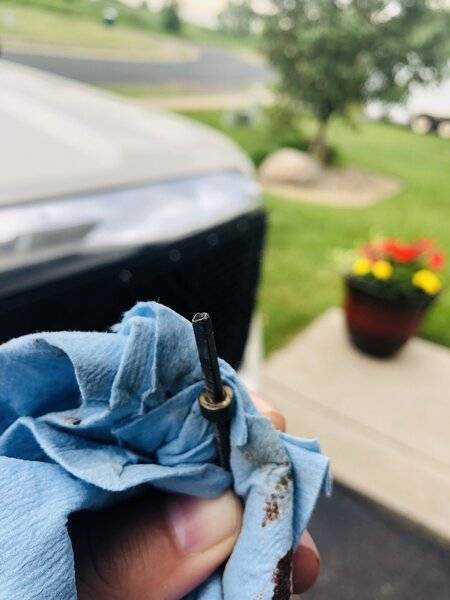

Got the cable removed to clean and lube it....to me this looks broke on the end that goes into the brass fitting behind the gauge cluster. Thoughts?
Don’t want to waste my time with this cable if it is broke - or is that how the end typically looks? The other end that goes into the tranny doesn’t look like a necessarily “clean” cut either on the cable....
They can also get broken strands in the cable.
An old mechanic showed me how to check the cable:
hold an end in each hand
make a u-shape towards the ground
make an O with one hand and let the cable end float inside your O or circle
Twist the other end with your fingers
if the cable jumps in your O hand it needs to be replaced
