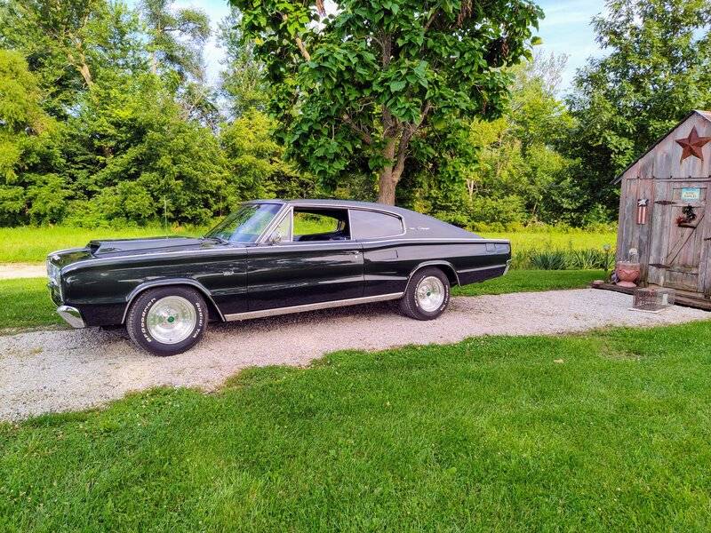

I have a 66 Charger, 383, 727, 3.23 suregrip rear. The car has been converted to 15" wheels. What do I need to do to correct my speedometer?

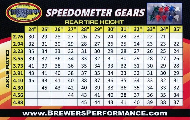

You know the gear ratio all you need to know now is how tall the tire is. Then use the gear chart.

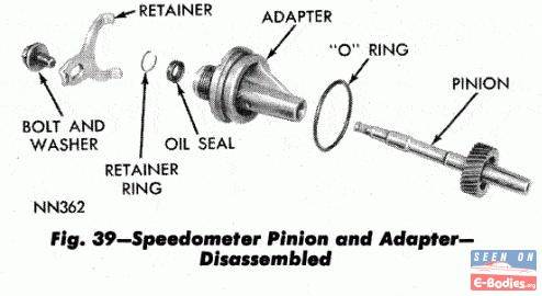

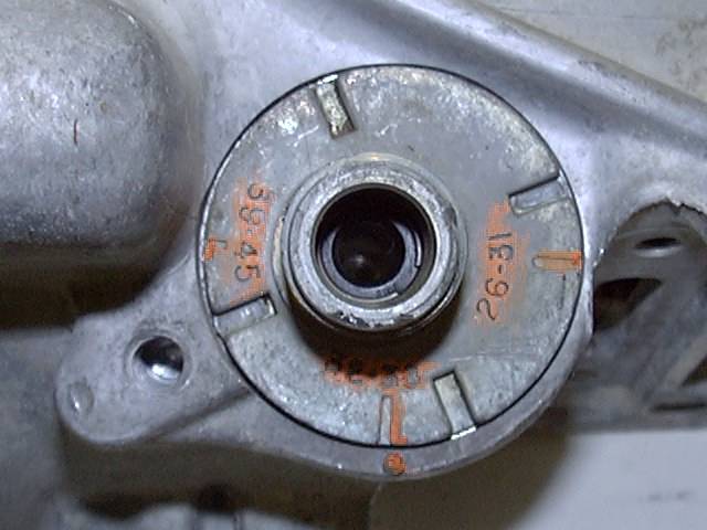

Look at the chart I posted. Not sure if you know where the gear goes but your speedometer cable is connected to it on the driver side of the transmission. Be sure to clock the thing appropriately. The housing that the speedo gear goes into has numbers on it and you have to line them up with the retainer.
Line the number range up to the dot on the transmission.
