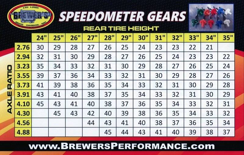

1966 Belvedere, 727 BB auto trans, 3.23 gears, 14" tire, which tooth speedo gear do I need to get me in the ballpark? I currently have no speedo so close is better than nothing.
I believe there is a chart here on this site from Brewers Performance, with all the info you are looking for.
Measure your tire height and select the appropriate gear.
Now all you need is the diameter of your 14” tire, do you know what size it is?

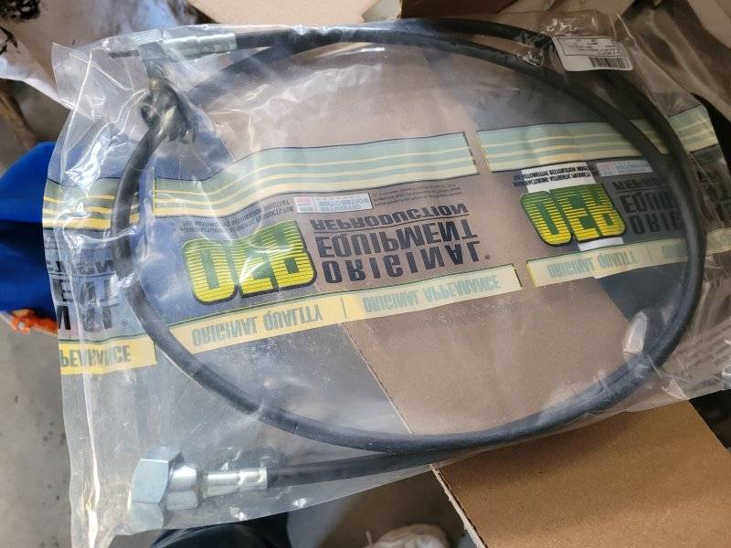

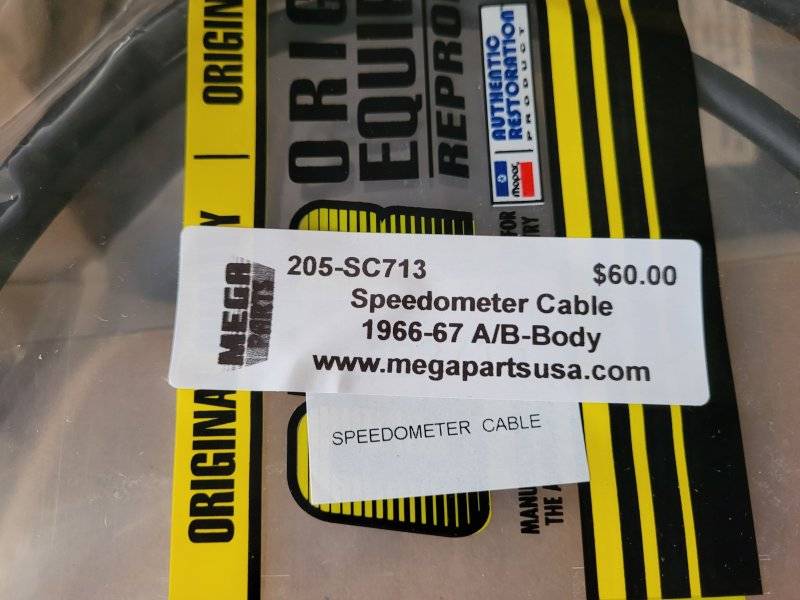

I got the gear and put it in, old gear had all the teeth worn off of it. Who makes replacement speedo cable and housing assemblies that are worth a crap? Mine is very tough to turn over by hand. I imagine at speed it gets worse. Thanks
Not going with Grundy btw.
Did you get a cable? Roseville Moparts sells them and I think Summit, Vans, and Layson’s also.
No, not yet. But thank you for that. I'll look at those places and see what they have. I need cable and housing, as I'm not sure which or both are bad on mine.
