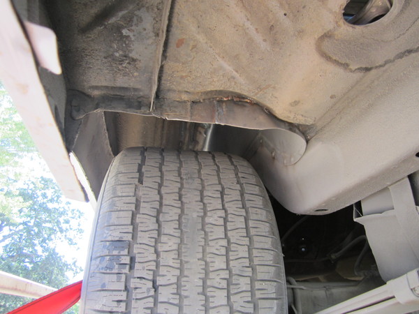

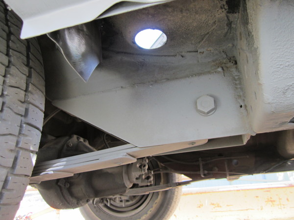

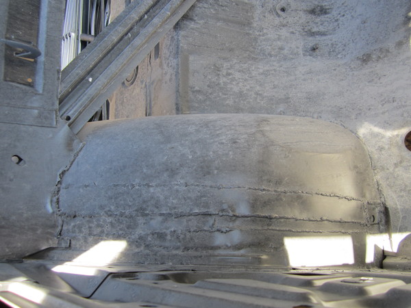

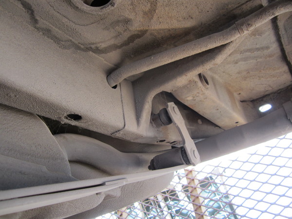

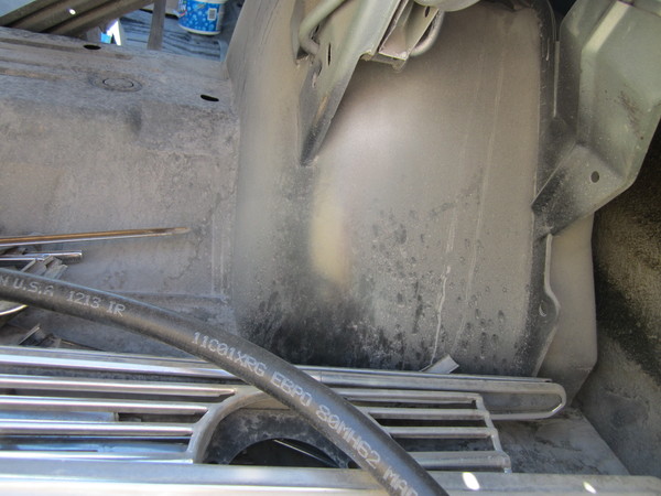

Here ya go! I did the spring relocation kit to my 66 belvedere. Cut the floor all the way to the frame rail. I actually did mine twice! The first time I mini-tubbed it I left the frame flanges on, which are about 3/4" wide, and my 295/50-15's rubbed on off camber driveways. Now that I'm restoring the car, I redid it removing the flange and have more room now. I had to bend the flange of the gas tank to clear the leaf spring, but didn't modify tank. In the pics, I have the inner shackel removed(I can't remember why now???) I think the trickiest part is getting the radius correct at the front and rear of the inner fenderwell. For the rear seat, you have to cut and relocate some supports in the back but the front stays the same. I didn't dress my ugly welds inside the car because they're hidden by the seat. In the trunk, I ground welds and finished with filler. Here's some pics. Good luck and go for it!

Mrbelv2, thanks for that description and set of pics! I'm also doing this (hopefully soon) to my '66 belvedereII and have been searching for this exact info.
Car is just a roller, awaiting paint. I think the shackels are like that because the leaf springs are coming off again. I just needed to get it rolling.

BINGO! Thank you very much for taking the time to take and send those pics. Thats EXACTLY what I needed to see and learn. I've had several folks look at the job and some have similar ideas and others have said "why bother" LOL "Cause she needs bigger meat on the rear end" !!!
