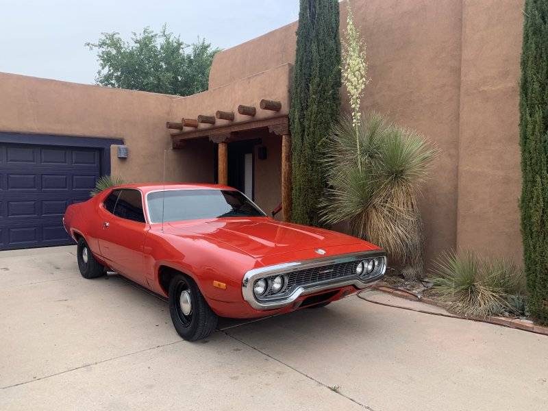

I wasn’t in the market when I saw this thing pop up on marketplace, but it was in my backyard and one of the top of my list of must-have body styles. The photos left quite a bit to be desired, and more than a few unanswered questions about the quality of restoration under some fresh red paint, but there was a fairly decent amount of good parts listed in the ad, and close enough to run up for an afternoon test drive. 400, Eddy heads, decent cam, 727, and sure-grip 9.25 checked some pretty good boxes for me, so I set up a visit.

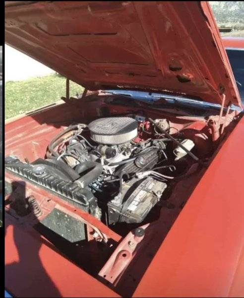

Sale ad photos (complete with the worst wheel selection I’ve ever seen):
The car was about 40 miles away, so I hopped in my poor man’s B-body and went for a look:
I was pretty impressed with what I saw. Body was clean and straight, a bunch of good parts had been thrown at it, it ran and drove good, and he was willing to come off the price, so we struck a deal and I went back to pick it up a few days later with the help of a friend.

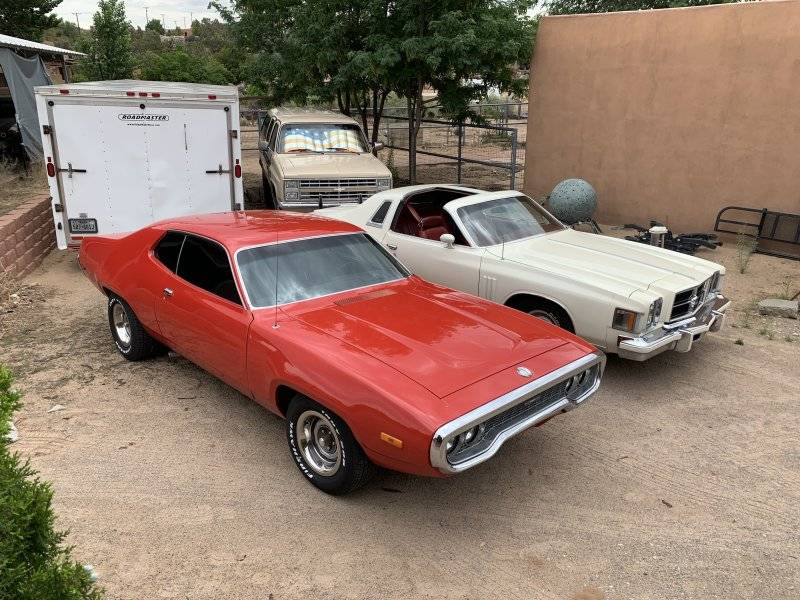

Part of our deal was he kept the wheels/tires, and I brought the set off my project Volare to get it home.
4.10s made for a bit of a jaunt highway rolling back home, but it was all smiles all the way, and we stopped to grab some burgers before heading home to meet the rest of the family.

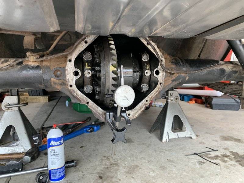

The diff in this car (along with the 400 and 727) came out of a 78 B-body. The suregrip was tight on it, but I treated the rest of the diff to a full rebuild using Yukon 3.55 gears and a master rebuild kit. Yukon uses all Timken stuff, which I’m a fan of.
Final pattern turned out really nice. This was an older set of Yukon gears made before they stopped lapping in each set:

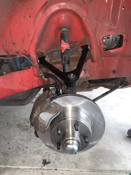

I had a few FMJ spindles and calipers left over from parts scrounging for my Volare, so I ordered up the 12” brackets from Dr Diff and a fresh set of brake hardware from Rock Auto. I picked up a lightly used set of Magnum Force UCAs while it was apart. The lower control arms were already rebuild when the car was upgraded to R/T springs and torsion bars by the previous owner.

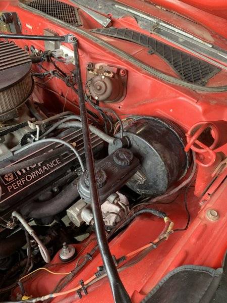

This was originally a manual brake car. The previous owner had added a power brake booster of unknown pedigree and painted it red. I had a spare K-car booster and M-body aluminum master, which is a great upgrade, so I made the switch. I’ll be getting the firewall reinforcement plate added later.

Improving the brake system is one of the best things to do on the old rides. Many only concern themselves with the go when the whoa factor is more important.

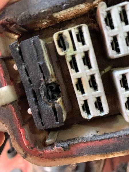

It all started with an almost electrical fire…
Driving back from brunch with the family and got that no good acrid burning smell, then gray smoke from the footwell (this is why I carry fire extinguishers, though luckily didn’t need it this time.
Limped it home and tore into the wiring under the dash. Turned out a previous owner’s shoddy repair had started to let go. The last owner installed a cheap amplifier in the trunk and neglected to bypass any of the factory charge wiring for it. I should have caught that sooner, I just figured he was smarter than that.
Luckily I had a spare 71 bulkhead connector that I’d snagged with an old Rallye gauge harness. I repinned the burned connector with the new/old one, then replaced the wires with melted jackets. I bypassed the ammeter entirely, and upgraded the charge wires to new 8 gauge wire with new connectors. Then I ran a 6 gauge wire directly from the alternator charging stud to the positive battery terminal junction on the starter relay. That should solve that problem for the time being.

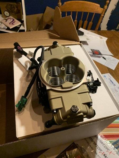

Terminator X:
Still have to decide which manifold I want to run. I traded a guy for a factory Air Grabber bulge, but I’m not sure I want to muddy up the clean satellite vibes with it. If I run the grabber, I’ll use the Holley intake. If not, probably the M1. Definitely going M1 if I throw in a stroker:

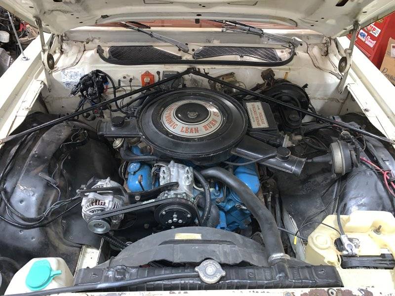

One other distraction this winter, but worth mentioning is the other 72 I picked up this winter. It’s a Charger SE, 400 2bbl, with 24k original miles. I have $1000 for the car without the engine, then went back and picked up the numbers matching 400 when the guy changed his plans. I’m scrounging the front end parts over time so I’ll be able to get it all back together. It will make a good future project.

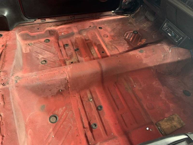

Got the interior all pulled and ready to start tunnel mods. Pretty clean pans to start with. There’s a few spots here and there that will need to be rectified, but overall really solid for a 50 year old car that’s likely led a hard life:

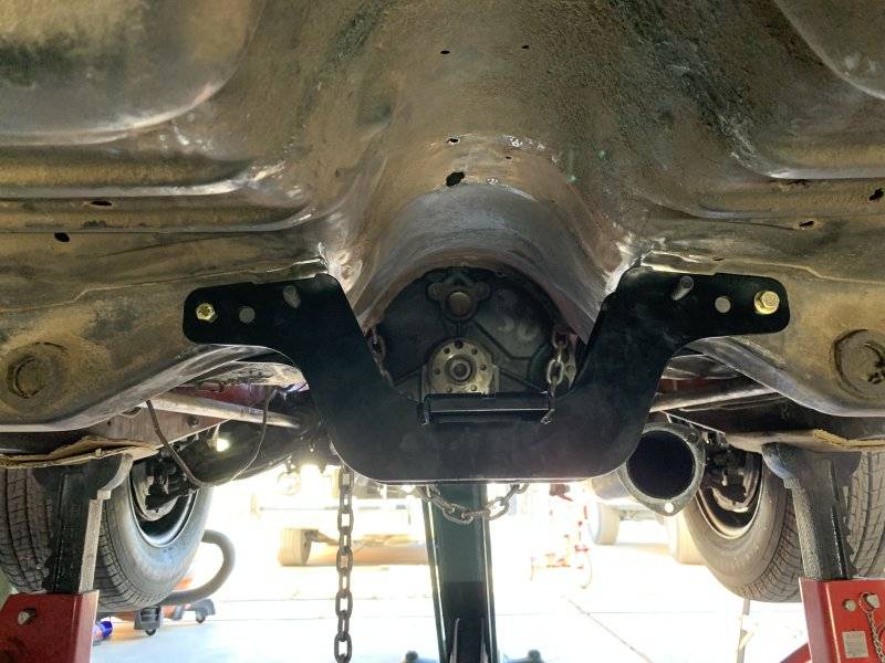

First up was the mods for the crossmember. The T56 requires removing the crossmember arch to make room:
Step 1 complete:

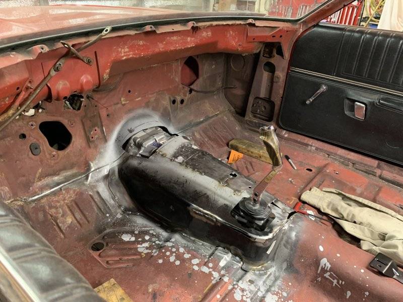

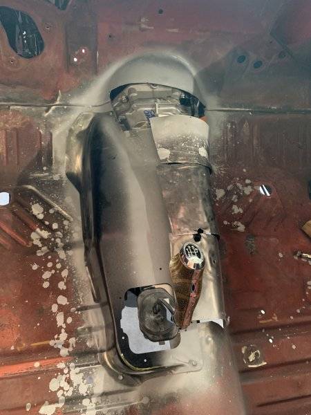

This post will address tunnel fab. In real time, this took a week of evenings, but here we’ll cover it in minutes!

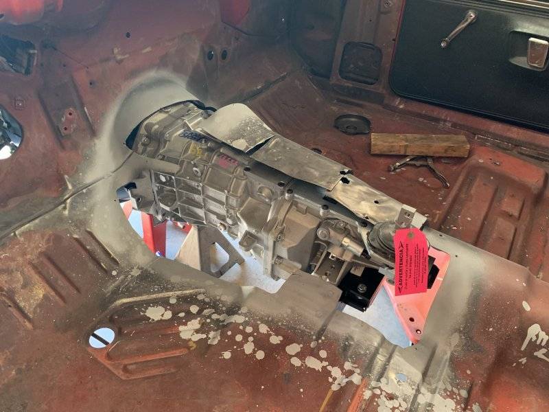

An initial fit test to assess my theory of whether this could all be done with factory metal.
Transmission up for an initial fit check on the passenger side widening. I plan to reuse a factory console with this, so keeping the tunnel tight is important for future carpet and console fitment.
Happy with the initial fit, and copious amounts of zinc primer applied to the overlaps, let the burning begin!
Tacking in and finish welding the forward piece that makes room for the larger bellhousing:
Pretty happy with the end result.
