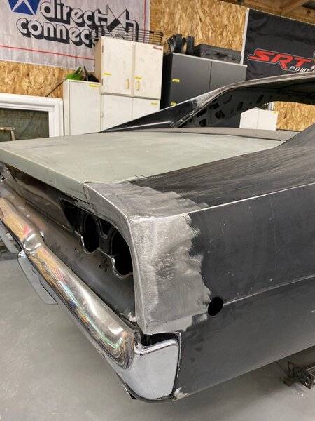

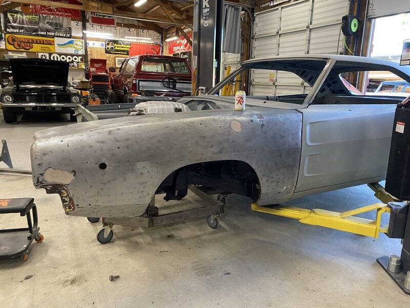

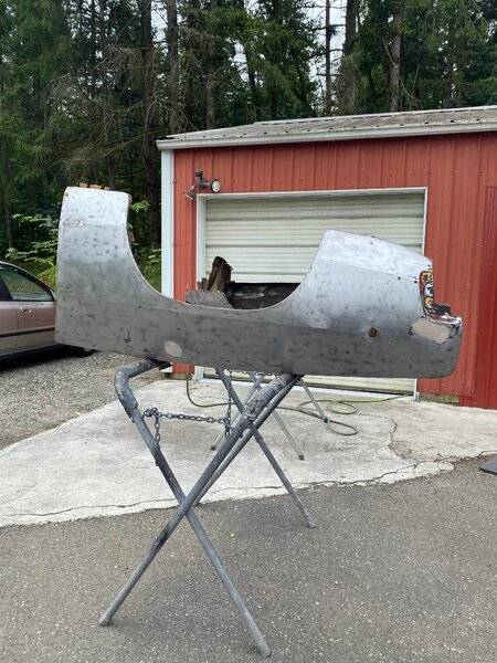

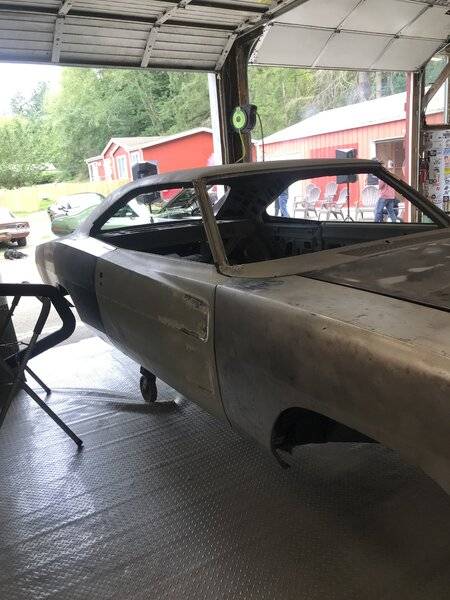

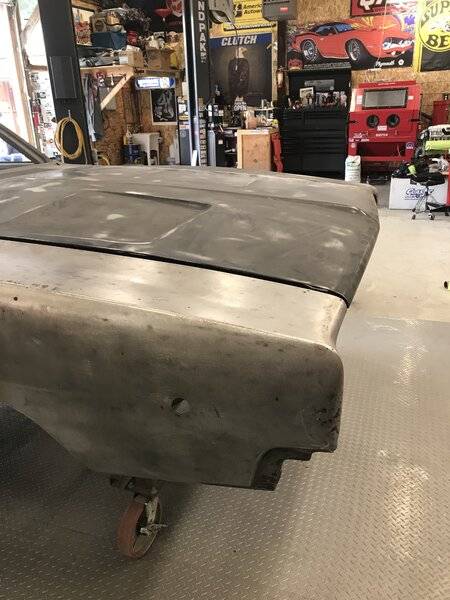

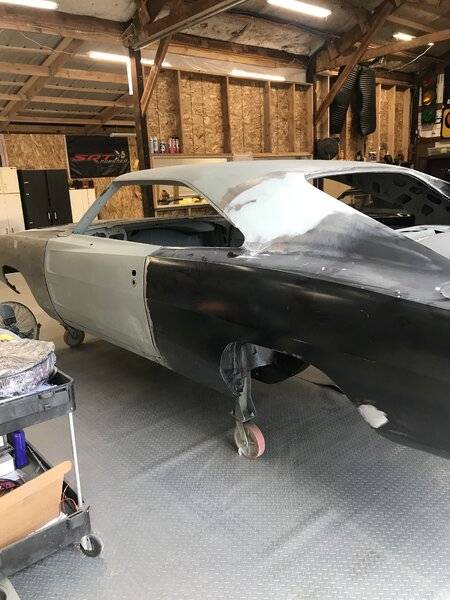

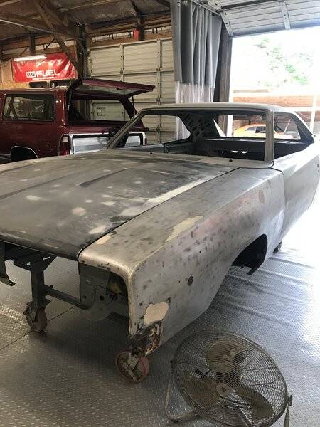

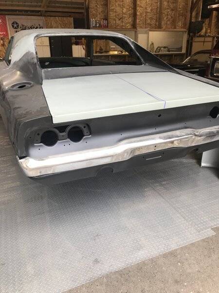

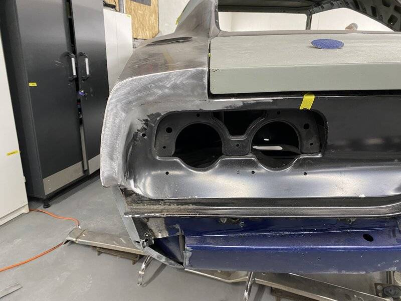

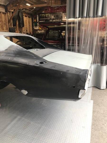

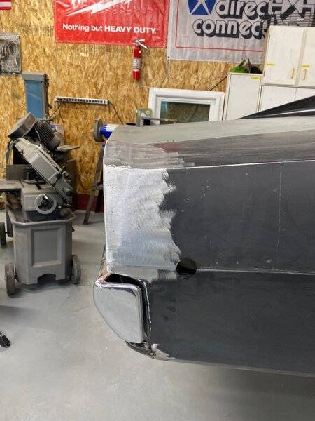

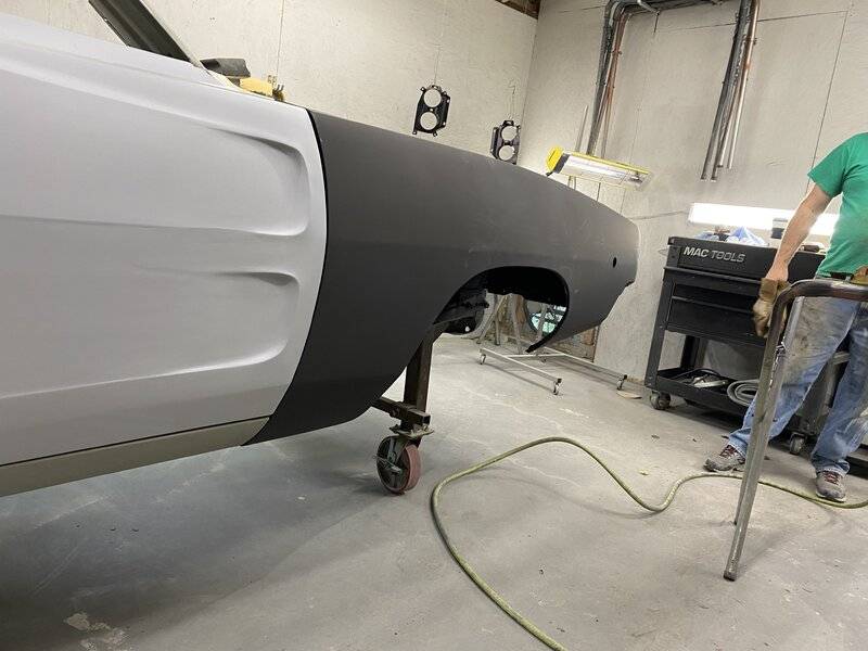

Aaron is fabricating the rear quarter extensions with metal with no seams or rubber gaskets.

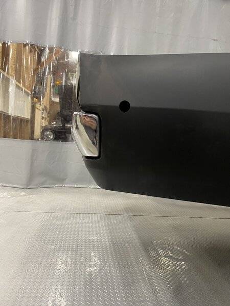

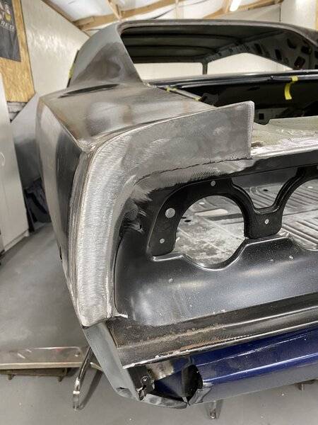

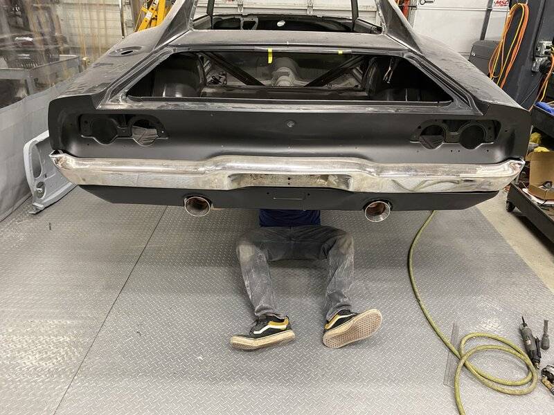

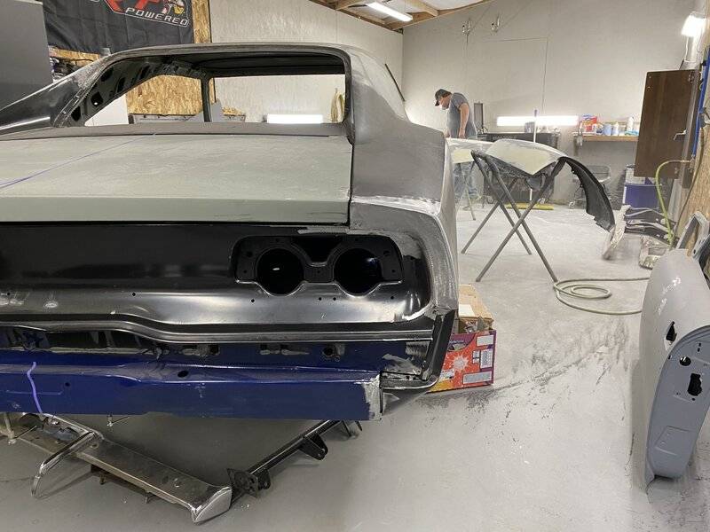

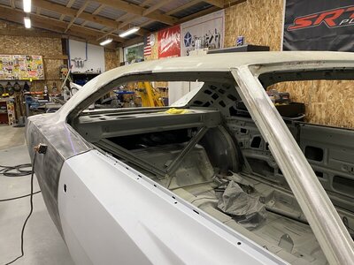

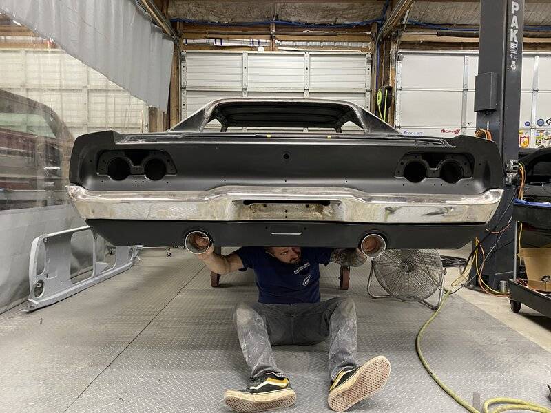

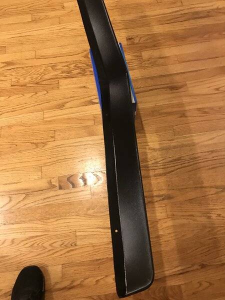

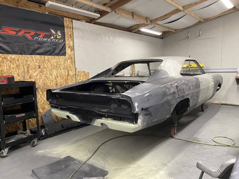

Update of rear exhaust in balance. And recess bumper. We shortened the bumper to recess into the body and bumper bolt delete. And bumperette delete.

Some purist types scoff at the valance corner seams being filled in but I like the look. I also like the quarter end cap changes you are doing. It makes me want to do the same to my project car. You have a blank valance being as you car is a '68. The exhaust pipe modifications don't disrupt anything for you. I'd like to integrate the reverse lights to the taillight assembles toward the center. I may never follow through with that though.
Good luck with the car.

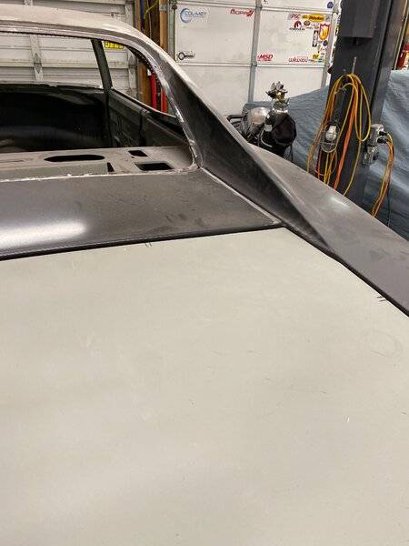

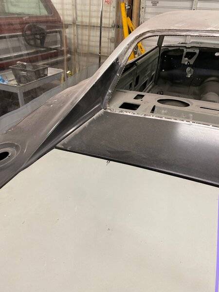

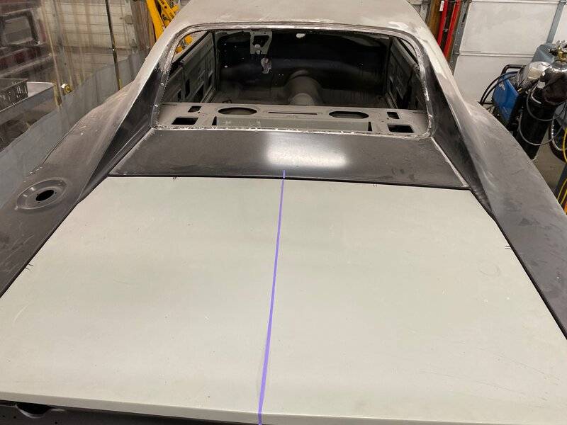

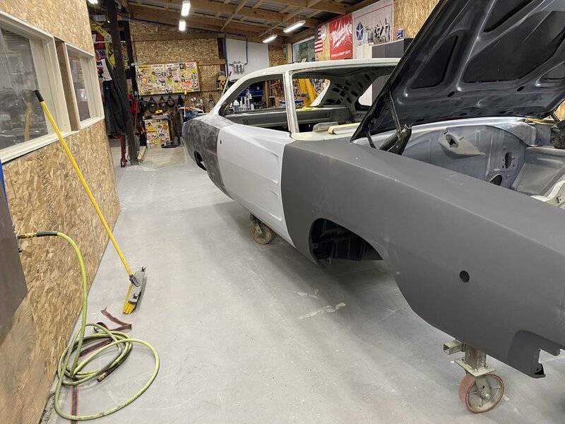

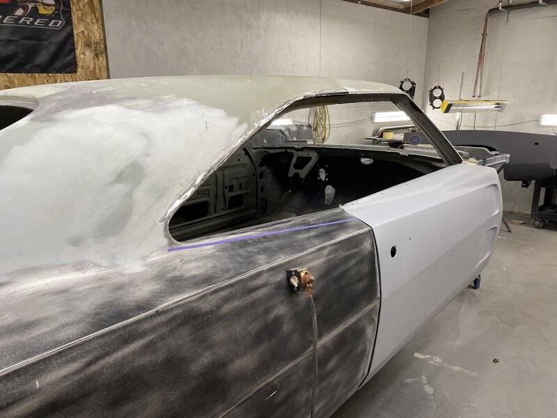

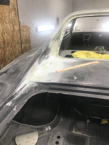

Rear window and wind tray, we are also deleting the wind tray seams.

That's coming together nicely!

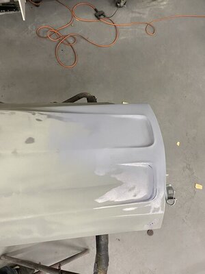

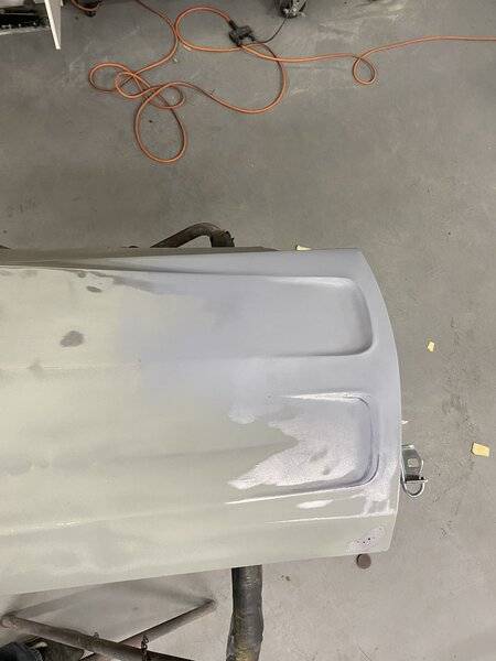

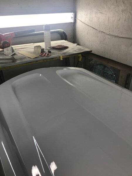

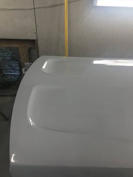

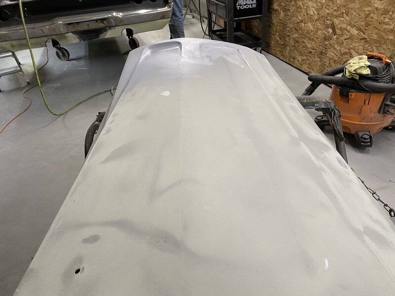

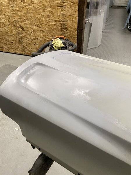

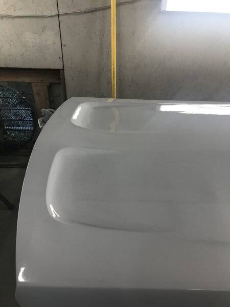

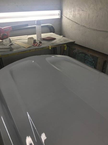

Modified the door scallops about 1/4 deeper. Left side done, right side next,
