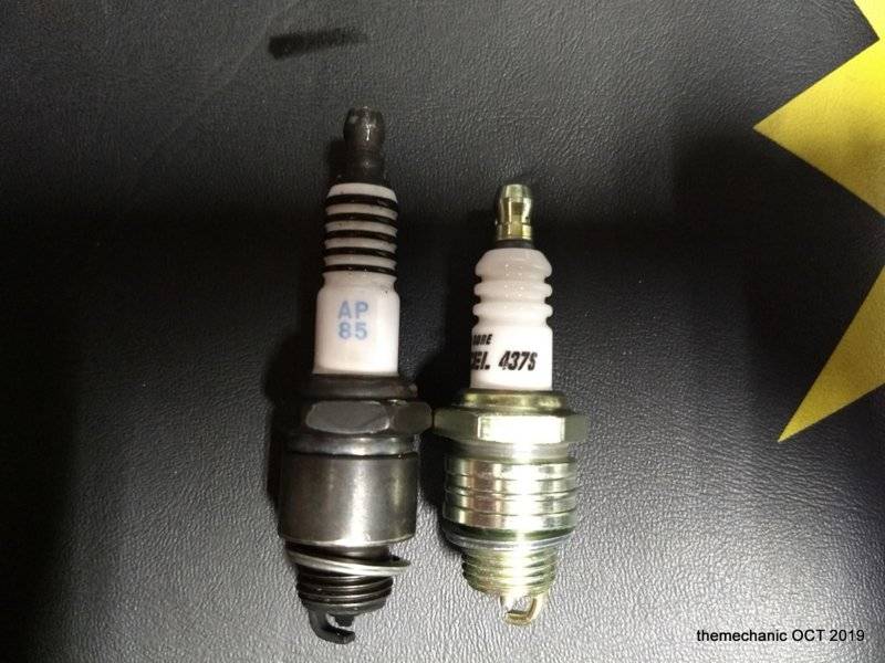

Here are some photos I took of the ACCEL 437S shorty/header plug beside the AP85 Autolite plug. The difference in length of the plug boot end is about 1/4".
I bought a set of 4 to solve a problem with non-flexible ceramic plug boots with 2" TTIs on a 440. The old wires were Firecore 50 45 degree and would flex just barely enough to get them over the standard length plugs on #2 and #4. The ceramic 45 degree boots hit the shock tower.
FYI, I ordered 2, 90 degree ceramic boots. Hopefully, problem solved.

It didn't matter since they were the only shorter plugs I could try. At the time, I was facing having to buy 2 individual 90 degree wires for $26 each until I found the 90 degree boots by themselves for $10 each.

I just re-installed the longer plugs that were in there and made some 90 degree wires. All is well again.
