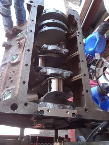

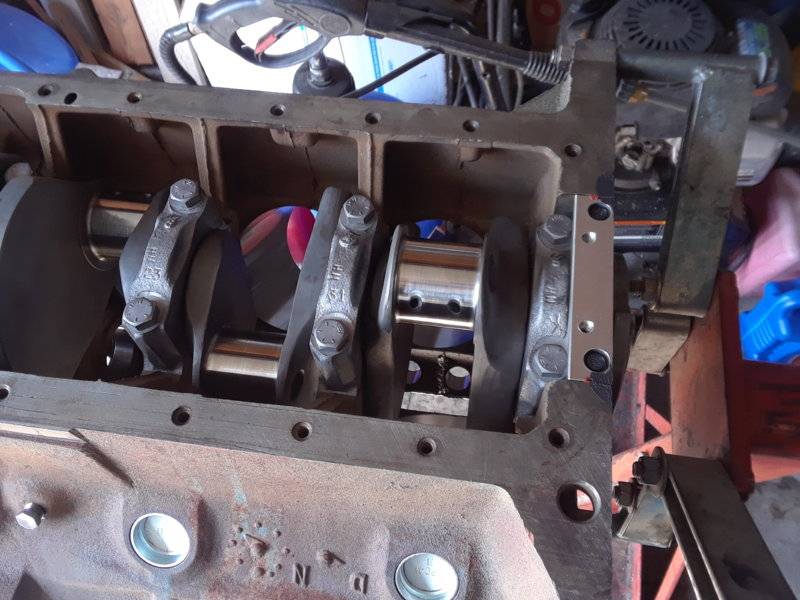

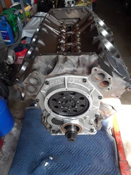

All clearances checked out great! Here's a few pics of the crank installed. Rear side seals were difficult to get in there. We used max oil resistant silicone on the outside of the rear seal mount. Never had a seal leak doing it like this.

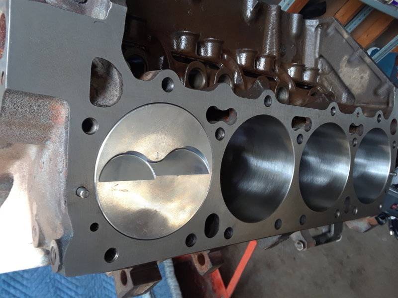

Not sure what it will make. The 496 was pulling the 2800 lb car low 11s at 118. Any idea what the power would be? Wallace Calculator should give an idea of what that motor was making. No main studs on that one either. Pistons are .015 above deck. Need to re think head gaskets now, .039 may not be enough. Only gives .024 piston to head clearance.
View attachment 749839 View attachment 749840 Not sure what it will make. The 496 was pulling the 2800 lb car low 11s at 118. Any idea what the power would be? Wallace Calculator should give an idea of what that motor was making. No main studs on that one either. Pistons are .015 above deck. Need to re think head gaskets now, .039 may not be enough. Only gives .024 piston to head clearance.
You can special order head gaskets from cometic , I`m told.
< 375 hp, uncorrected flywheel
Sounds about right. Guys say they are shooting for 600 horse. So if they get there, then they should be running in the 9s at about 135 MPH, right? Not hard at sea level, but try that at 5400 feet!
Found some Cometic head gaskets with a thickness of .051". That puts piston to head at .036" quench clearance. I can live with that ( and so can the motor) LOL. Will use the C 5464-051 gasket. Pricey at $88 each, but the alternative is piston clearance at .024" from the head at TDC, which is too close for my comfort. I may try .025 on a motor built from leftover parts, just to see what happens.

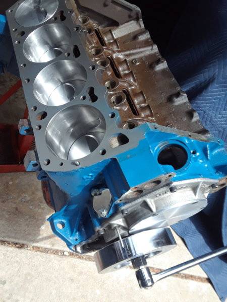

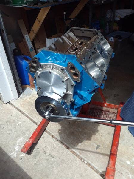

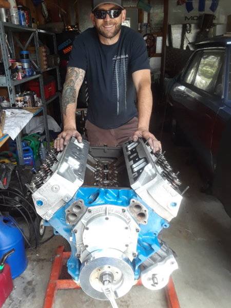

Ok, so got all the rings fitted, pistons in, bolts torqued, painted, oil pan on. Here's a few pics. I like the 72 Chrysler blue engine paint.
Oh yea, its taking 28 lbs of torque to turn the motor over, without valve train installed. That's good! Used 17 lb tension oil rings. 440 Source seems to think those are adequate to keep oil consumption under control. Set top ring end gap at .020, 2nd one at .025. Some builders say this greatly reduces ring flutter and blow by on big bore engines, above 3500 RPM.

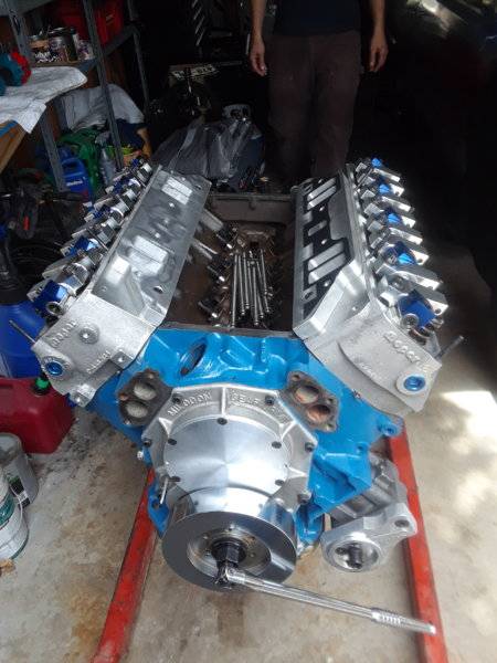

Got the heads and oil pump on today. Put in a spark plug, turned it over, and it kept turning back, like a spring would. Rings are sealing really well! Compression was taking about 10 -15 seconds to go past the rings when rotated to TDC........Now we're setting the rocker side play, and getting them centered on the valve stem.

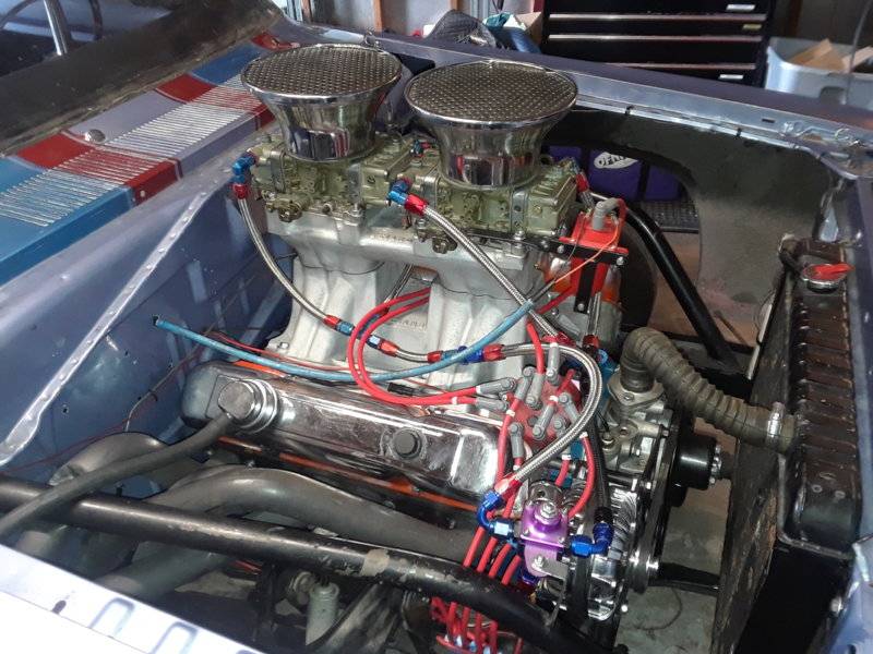

Finally got it in, and it's running great! Drove it down the street today, and it's very responsive, with great torque! Taking it to the track tomorrow for some testing.
Finally got some runs in last night. First one was 11.05@118. Then advanced timing from 32 to 36, and it ran 10.93@119. 3300 lb car, not sure what the horsepower is, but it's running really strong! Sounds great! Real happy with it so far.
Wallace calculator shows a 3300 lb car going 10.9 in the 1/4 mile, is making 502 horse at the flywheel. Sounds about right. I'm sure the hi stall T Converter is eating up some of the power.
