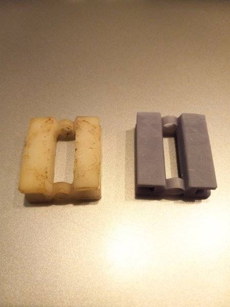

Everyone knows these clips that hold up the steering column in our b bodies. They are becoming pretty hard to find. Mine were pretty beat up. Had some collapsed corners
Thanks to world of 3d printing. I was able to make my own. Almost identical in every way. !!
Nice!
Any way to make them with a white colored polymer?
There is white resins available for sure . I just don't usually buy it. I paint everything I print, so it more cost effective for me to just buy a single color. Unless I am trying to make something that is see translucent ( another project I am working on right now ! )
I will probably just paint these with 2k primer with a flex additive to give a slight satin finish.

I think this is true. Had a fellow her in Ontario cananda trying to source some for his 69 charger. He told me that they were not being reproduced any more by mopar and was having a hard time finding them without paying an crazy amount to have them shipped here.
But I printed off a few for him and myself.!
