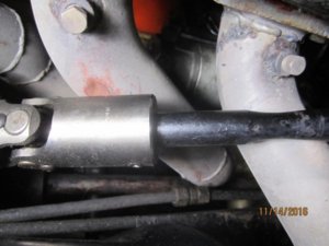

Changed the rag joint to Flaming river
so...."steering coupler" if it's a solid piece of metal & commonly called a "rag joint" (as HemiItis says) if there is a piece of rubber/cloth/etc. sandwiched in the middle.
