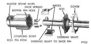

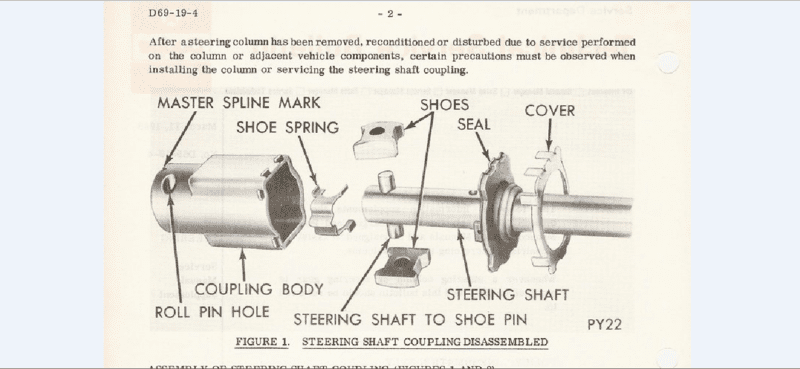

Here ya go. Did you install the roll pin?
This one is a little different looking because its a 1962 but the shoes and clip are the same.

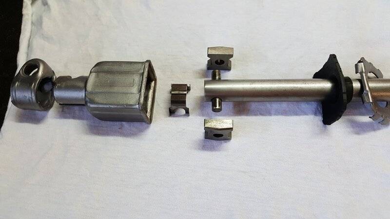

Look closely at the pointed ridge on the shoe. You probably have them front to back instead of side to side.
The clip goes under the shoes to hold them outward

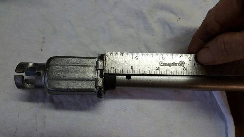

After you get the coupler assembly together you will notice a small hole partially drilled in the shaft itself just above coupler. When the column assembly is installed in the car that hole should be approximately 13/16 from the coupler body. You can reach that demension by pulling up or down on the column assembly before tightening clamp under dash. This will center shoes in coupler body.
